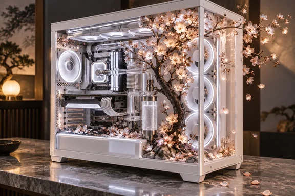

The core of the build is a model cherry tree inside the case. The Cherry Bloom contains 70 handcrafted cherry blossoms that physically open as the hardware heats up during gaming. The flowers are made from a temperature-reactive titanium alloy and are individually formed and hand-painted. There are no motors controlling them and the effect is not produced by RGB lighting. The petals gradually open as the system warms and close again as it cools. That is how VideoCardz described it, and VideoCardz was the outlet TechRadar credits with first spotting the machine.
Tom's Hardware reported the same mechanism separately: there are no motors to break; the blooming blossoms are completely 'powered' by the heat generated from the high-end components in the PC. Aftershock's own showcase page puts it more simply: as your PC warms during gaming, the blossoms bloom. As the system cools down, the tree returns to rest.
Aftershock calls it the "world-first blooming Gaming PC." That is the company's own marketing. Nobody has published a survey of earlier case mods that could confirm or disprove it. What reviewers do agree on is that it looks new. Tom's Hardware wrote that "We've never seen anything like the Cherry Bloom PC from Aftershock PC in Australia".

Aftershock hasn't published much detail about how the flowers work. Its presentation shows the tree resting at 18°C, with all the flowers closed. It hasn't said what temperature makes them start to open or open fully. It also hasn't said whether they respond to air inside the case, heat from the coolant loop or from a particular component, or what the alloy actually is.
The Tech Revolutionist, a Singapore-based outlet, noticed the same gap. It reported that Aftershock says the effect uses the PC's heat without compromising thermal regulation, although it has not supplied independent temperature measurements or detailed the mechanism that translates heat into movement.
That gap limits one idea that has come up in coverage. TechRadar wondered whether the concept could replace a digital temperature display as a clearer warning when a machine hits a heat threshold. It's a nice thought, but the Cherry Bloom as sold can't do that job. With no stated opening temperature, calibration or response time, the petals give you a rough, delayed sign that the system is working hard. They can't tell you whether your GPU is running hot. Anyone who needs real thermal data should keep using software monitoring on this machine, just as on any other.
The cooling system itself is ordinary liquid cooling. The Tech Revolutionist describes it as a custom liquid loop with dual 360mm radiators, a D5 pump and reservoir, rigid acrylic tubing and eight chassis fans. Its point is that the concept gives waste heat a visual role while the separate liquid-cooling system continues carrying heat away from the processor and graphics card. In other words, the tree reacts to heat the system is already producing. It doesn't cool anything.

Aftershock's own material doesn't agree on which case the tree sits in. The showcase page says the CHERRY BLOOM PC is built in the NOVACORE, giving the entire design a stunning 270° seamless glass view. The company's launch post on X also says "Built inside NOVACORE." The detailed specification on the sales listing, however, names an APNX V2 White.
Independent outlets went with the APNX name. Tom's Hardware reported that the chassis used for the Cherry Bloom is the "V2" by Taiwan's Advanced Performance Nexus, better known as APNX, with wrap-around glass on three sides. TechSpot also says this all takes place inside an APNX V2 White case that offers a 270-degree view of the inside. One likely reading is that NOVACORE is Aftershock's own name for its build of the APNX V2. That is an inference, though, and the company hasn't confirmed it.
