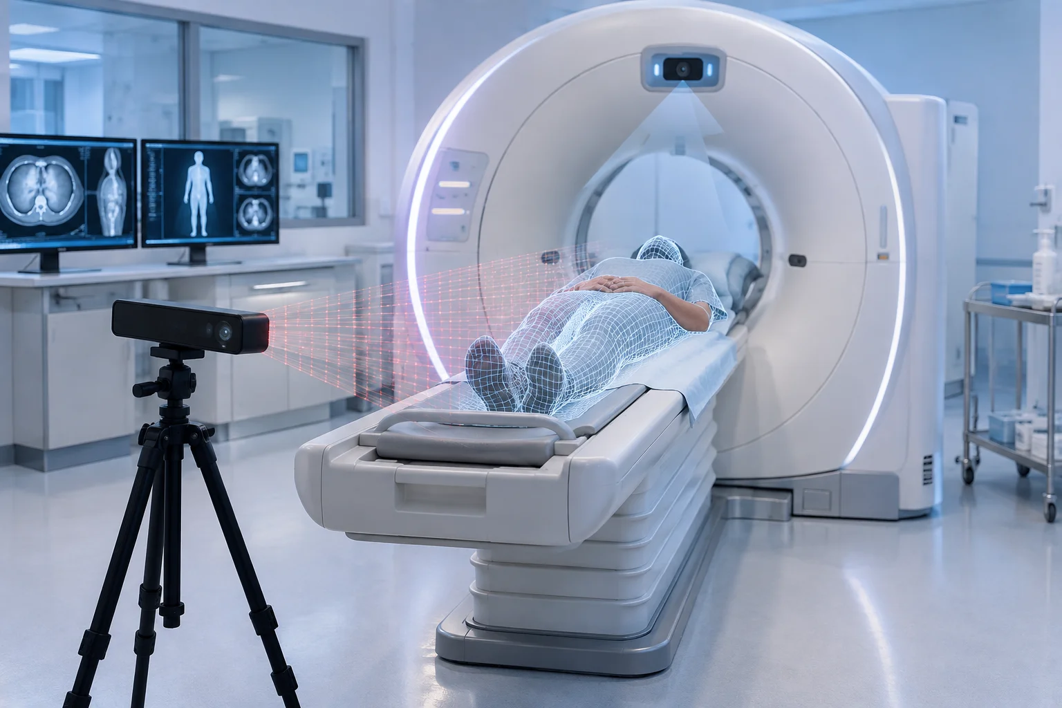

A patient lies on an MRI table as a camera projects red scanning lines in a modern imaging room.

A patient lies on an MRI table as a camera projects red scanning lines in a modern imaging room. What the post claims, and what it leaves out​
