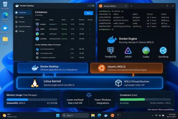

Windows desktop shows Docker Desktop and Ubuntu WSL2 running four containers: PostgreSQL, Jellyfin, Caddy, and Syncthing.
XDA Developers’ test of moving a Jellyfin, Caddy, PostgreSQL and Syncthing stack from Docker Desktop to Docker Engine installed inside Ubuntu on WSL2 identifies a real trade-off: Docker Desktop can leave meaningful idle overhead on a Windows 11 PC, while a direct WSL installation removes its dashboard and Windows-side integration. But the article’s explanation for the saving is wrong in a way that matters to anyone trying to reproduce it.
Docker Desktop’s WSL2 backend does not create a second virtual machine inside WSL’s virtual machine. Docker’s own documentation says WSL2 distributions share one Linux VM and one kernel; Docker Desktop runs its engine in a separate docker-desktop distribution within that shared WSL environment. Microsoft likewise describes WSL2 as a managed VM that hosts the Linux distributions. Replacing Docker Desktop with Docker Engine inside Ubuntu can reduce processes, services and retained memory, but it does not remove a layer of nested virtualization that was never present in the WSL2 configuration.
That correction does not make the XDA result meaningless. It changes what the result actually proves: the author measured the cost of Docker Desktop’s management layer on one machine, not the cost of an extra VM. For Windows users operating containers continuously on a desktop, home server or small lab machine, that is still useful information — provided they compare the two setups properly.
Docker Desktop and Ubuntu WSL share the same WSL2 VM​
The visual clue that misled the XDA test is familiar to many Windows users: running wsl -l -v can show Ubuntu next to Docker-created distributions. Older Docker Desktop installations commonly exposed both docker-desktop and docker-desktop-data. Those names look like separate virtual machines, but they are WSL distributions, not independently booted Hyper-V guests.
Docker’s current WSL2 documentation is explicit that distributions run side by side on a shared kernel. Its Resource Saver documentation makes the point even more clearly: in WSL mode, Docker Desktop cannot stop “its” Linux VM when idle because the WSL VM is shared by all installed distributions. Instead, it pauses Docker Engine inside the docker-desktop distribution.
The docker-desktop-data detail is also dated. Docker began changing its storage layout with Docker Desktop 4.30, replacing the dedicated data distribution for fresh installations with a managed VHDX storage arrangement. Systems upgraded from older releases may still retain docker-desktop-data, so the XDA author’s observation can be accurate for that PC without describing how every current Docker Desktop installation is laid out.
This is more than architecture trivia. If Task Manager shows a large VmmemWSL memory figure, that number belongs to WSL’s shared VM — potentially including Ubuntu, Docker Desktop’s distribution, Linux page cache, development tools, databases and containers. It is not a clean Docker Desktop meter. A before-and-after screenshot of Task Manager cannot establish which portion came from Desktop’s own services unless the test controls the rest of the WSL workload.
