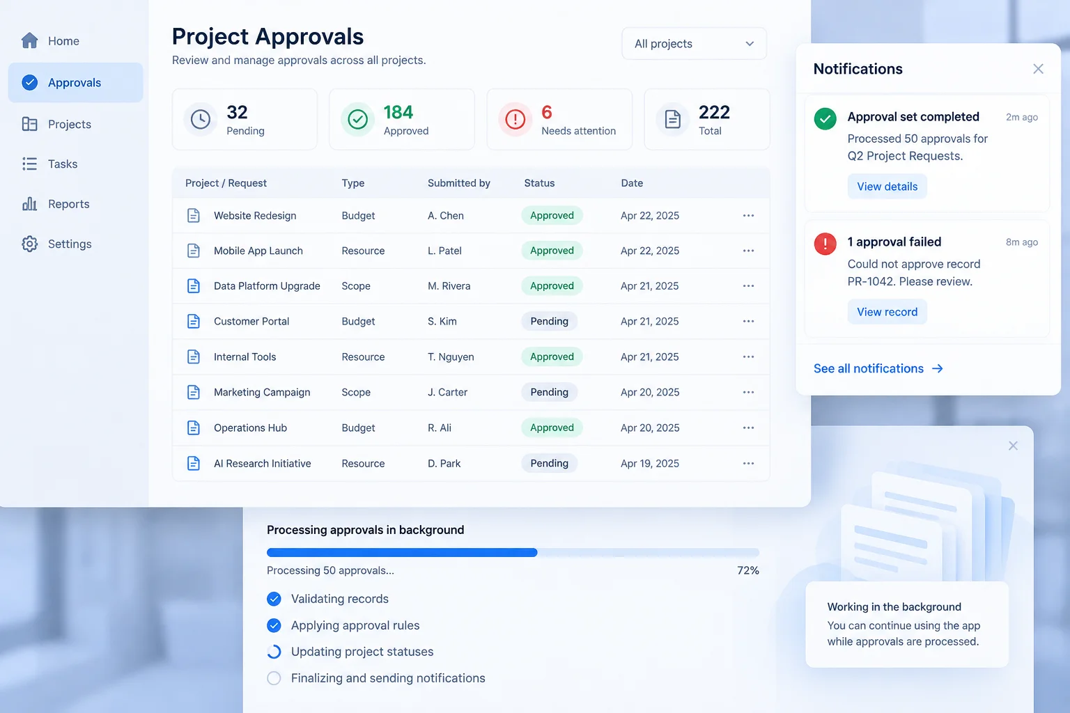

Project Operations approvals can run in the background through a scheduled cloud flow. The new feature lets the person who started an approval set find out when it is done.
- Who gets notified: the user who started the operation, and only for operations they triggered.
- On success: a brief pop-up names the approval set, says it completed, and links to the record. The notification stays in the notifications pane until you clear it.
- On failure: if one or more approvals in the set fail, the notification says the set completed with failures. It gives the failure reason and links to the failing record. Multiple failures produce separate notifications, not one summary.
- What it doesn't do: it sends no "processing started" notice, no email, and no Teams message. It adds no retry or remediation workflow.
In short, this is a completion alert delivered inside the app. It is not a monitoring or repair system.
