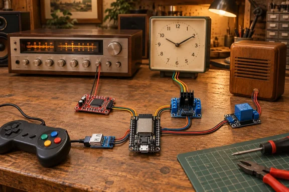

The ESP32 retrofit starts with the old gadget's interface
How-To Geek's argument is easy to follow. ESP32 boards are cheap and come with Wi-Fi and Bluetooth, and hobbyists have published working code that does the hard part. What the roundup skims over is how little the four projects share. One decodes an audio stream. One acts as a USB host. One drives a clock motor through an H-bridge, and one closes a relay across a chime circuit.
Taken together, they show where the real work is in this kind of project. The ESP32 supplies the radio and the processing. The part that decides whether a build succeeds or burns out is the interface layer: an audio decoder, a USB OTG adapter, a motor driver, a relay. A board that suits one project can be wrong for another, and pin assignments copied from one build rarely carry over to a different board.
The sections below follow each build as its author documented it. They separate the author's reported results from How-To Geek's framing and point out where a reader's own hardware might differ.

What this means for you
Start with the old device, not the ESP32. Identify its interface (line-level audio input, USB HID, proprietary connector, polarity-reversing pulse circuit, or low-voltage chime loop) and then pick the board and interface hardware the matching project specifies. If you're a Windows PC gamer, the controller builds are the most directly useful. A Seeed XIAO ESP32S3 running bt-gamepad pairs like any Bluetooth controller, but check button mappings in your games. The clock and doorbell builds call for more care with electricity than with code.
- Buy the ESP32 variant each project names.
bt-gamepadtargets the ESP32-S3 because it relies on USB host, while Paul's audio receiver uses an ESP32-WROOM-32U with Bluetooth Classic A2DP. - Budget for the parts beyond the microcontroller, such as a VS1053 decoder, OTG adapter or powered hub, L298N driver, or relay, before comparing the cost with a retail Bluetooth receiver.
- If a USB controller won't enumerate or keeps resetting on the XIAO ESP32S3, add a powered hub, as the
bt-gamepadREADME advises. - Check a slave clock's rated voltage and pulse scheme before wiring it. The Pragotron PJ 27 build uses 12 V pulses of alternating polarity, but these clocks also came in 6 V, 24 V and 60 V versions.
- Keep doorbell work on the low-voltage side of the transformer, and have the ESP32 fire the chime locally so the bell still works when Home Assistant is offline.
- Copy pin maps only when you're using the same board as the author, and treat battery and current figures in project READMEs as the author's claims.
Together, these four builds show that an ESP32 can give old hardware a second life for the price of a few parts. They also show the pattern behind every one of them: a working project comes from reading the old device's signals and powering it correctly, and choosing a microcontroller is the easy part. For anyone starting out, the natural next step is the one How-To Geek ends on: learning what separates the ESP32, ESP32-S3 and other variants, because that choice decides which of these projects you can build at all.
