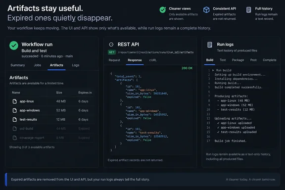

Dark dashboard showing available workflow artifacts, REST API results, and full run logs that retain expired artifact history.
