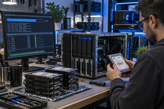

A technician inspects a hard drive beside an open server rack and monitoring screens.
