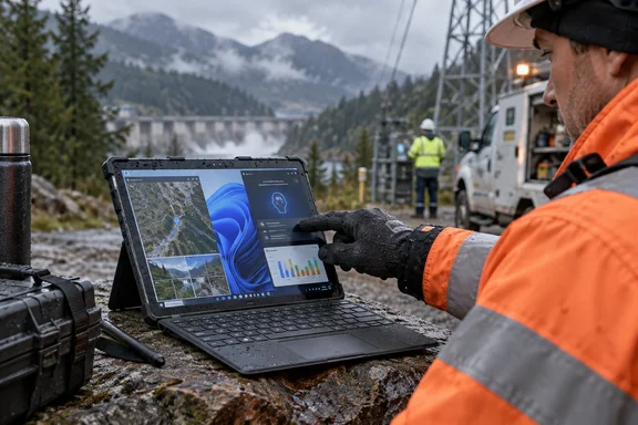

A worker in orange safety gear uses a rugged tablet at a misty mountain dam site.
Panasonic has announced the TOUGHBOOK 34, a rugged detachable Windows 11 2-in-1 that is also a Copilot+ PC. The European launch took place in Wiesbaden, Germany, on September 30, 2026. Panasonic built this one for utility crews, surveyors, fire services and anyone else whose laptop gets rained on. Panasonic says the TOUGHBOOK 34 is built for teams that need maximum mobility and productivity in one rugged 2-in-1 solution.
