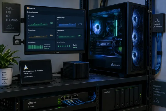

A portable monitor mounted to a Proxmox host can make a homelab easier to diagnose, but the useful part of MakeUseOf writer Dipan Saha’s setup is not the $63 screen or the double-sided tape. It is the decision to treat the display as a local kiosk: a dedicated, always-on view of health metrics with a direct console available if the network path fails.
Saha’s September 17 report describes attaching a 1080p USB-C portable monitor to the side panel of a converted gaming-PC server, powering it from a motherboard USB port and feeding video from the processor’s integrated graphics output. The screen runs Grafana in Chromium through the Cage Wayland compositor, presenting Prometheus-collected statistics rather than a normal desktop.
For Proxmox VE users, that is a workable idea with one large qualification: a dashboard must not turn into an unauthenticated management surface. The article’s shortcut around Grafana login requirements is the part readers should examine most carefully before copying anything. A display that is intended to be visible from across a room does not need administrative access, and making it a browser session on the virtualization host creates a wider failure and security domain than the project initially suggests.

Saha’s small HDMI display provides a simple out-of-band fallback for that category of problem. If the host has an iGPU enabled, connecting a display to the motherboard video output gives the administrator a local login prompt without rolling in a separate crash cart. That can be especially handy for a single-node homelab where there is no IPMI, iDRAC, iLO, PiKVM, or serial-console infrastructure.

The more consequential design choice is where the graphical kiosk runs. Saha avoids installing a complete desktop environment and instead uses Cage to launch Chromium fullscreen on a virtual terminal. Cage’s own project documentation describes a systemd-based kiosk model that can replace a getty on a chosen TTY and start an application automatically at boot. It is designed for this sort of single-purpose display.
