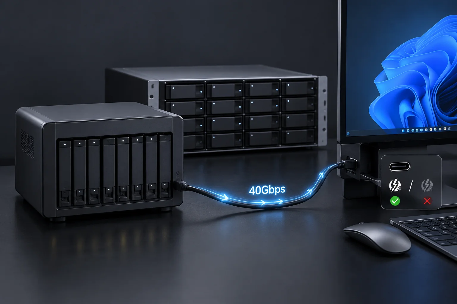

A multi-drive storage enclosure connects to a monitor via a cable labeled 40Gbps, with a speed compatibility graphic.
QNAP has announced two USB4 storage expansion enclosures and a dual-port PCIe card to feed them. The headline is 40Gbps over a single USB-C cable. The fine print matters more than the headline, especially if you plan to attach one of these to a Windows 11 PC.
A multi-drive storage enclosure connects to a monitor via a cable labeled 40Gbps, with a speed compatibility graphic. What QNAP announced​

Both enclosures take SATA drives, and QNAP lists 3.5-inch and 2.5-inch HDDs and SSDs. Both have one USB4 Type-C host port. Both also ship with a USB4 cable in the box. The enclosures are sold without drives.
The desktop model is aimed at creators doing 4K/8K video work and backups. The rackmount model is aimed at server rooms and SMB backup. QNAP's product page says its dual power modules are meant to keep it running without interruption. An optional RAIL-B02 rail kit fits standard 19-inch racks.
Compatibility: the part that will bite you​
The most useful detail is a negative one. QNAP says the TL-D810TC4 works only with USB4 and Thunderbolt 4 ports, and that USB 3 and earlier versions are not supported. A USB-C connector on your PC does not guarantee the box will work.

  • Connect the enclosure directly to the host. QNAP says not to put a USB hub or dock in between.
  • QNAP recommends a USB cable no longer than 1 meter.
  • To get the full 40Gbps and PCIe tunneling, the host must support USB4 or Thunderbolt 3/4. QNAP also says actual speeds depend on the device and cable.
