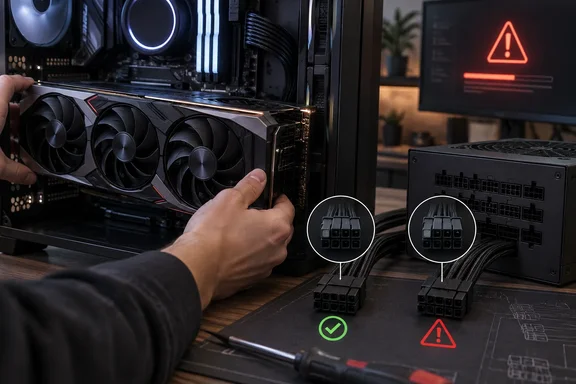

Installing a triple-fan graphics card, with PSU connector compatibility shown by green check and red warning.

The connector is familiar; the wiring behind it may not be​
PCIe auxiliary power connectors are standardized where they meet the graphics card. The modular connector on the other end of the cable, where it attaches to the PSU, is not universally standardized. Manufacturers can use the same-looking multi-pin housing while assigning individual positions differently across product families, revisions, and sometimes generations of the same brand.
be quiet! explicitly warns in its support FAQ that cables from other models, earlier series, or other manufacturers can trigger protective circuits because the pin assignments differ. Seasonic, ASUS, and Corsair publish comparable compatibility warnings: use the cable supplied with the specific PSU unless the manufacturer documents compatibility for the exact model family.
That distinction is easy to miss during an upgrade. A builder sees an unused eight-pin socket on the power supply, finds a cable with a matching plug, and assumes the job is done. The system may then send 12V where the attached cable expects ground, or create a short as soon as the PSU is switched on. A protection circuit can stop the event quickly, but it is not a guarantee that nothing downstream was exposed to the fault.

  • Disconnect AC power, switch the PSU off, and remove every modular cable whose origin cannot be tied to that exact PSU model.
  • Do not reuse a cable just because it has the same number of pins, the same sleeve color, or a familiar connector shape at the component end.
  • Inspect the PSU sockets, cable terminals, GPU power sockets, motherboard connectors, and nearby PCB areas for melted plastic, discoloration, loose pins, or a burnt-electronics odor.
  • Rebuild the minimum configuration with a known-good PSU and only its original or manufacturer-approved cables, then test outside a cluttered cable setup if practical.
  • Avoid connecting valuable drives or the new graphics card until basic power-on behavior is stable; a mismatch can affect more than the component that first drew attention.
  • Contact the PSU maker with the exact model and cable markings if original leads are missing. Do not rely on marketplace listings that call a cable “universal” without a documented compatibility table.
For experienced builders, a continuity test can help compare a cable against an authoritative pinout, but it is not a substitute for manufacturer confirmation. Testing an unknown cable incorrectly—or assuming that a shared connector housing means shared electrical mapping—can reproduce the original mistake.
