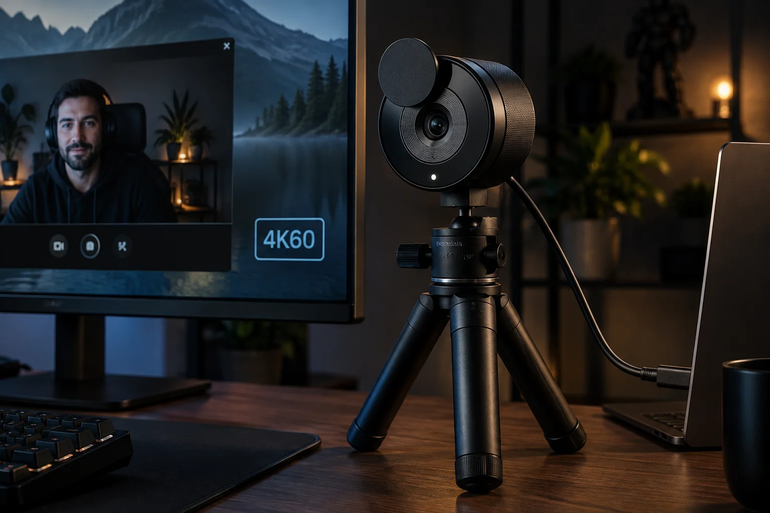

A tripod-mounted webcam faces a monitor showing a man on a video call at a dimly lit desk.

A tripod-mounted webcam faces a monitor showing a man on a video call at a dimly lit desk. Hardware Specifications and the 4K60 Edge​

The Ergonomic Reality: Why You Need a Tripod​
If you are picturing a sleek little clip-on camera for your thin-bezel monitor or laptop lid, recalibrate your expectations immediately. Measuring in at a hefty 380 grams, the Kiyo V2 Pro is enormous by webcam standards.
While Razer equips the camera with a pivoting L-shaped base designed to rest atop a display or attach via a standard 1/4-inch thread, Windows Central found that mounting it on a standard 24-inch monitor felt precarious and unstable, and clamping it onto a laptop screen is completely out of the question. Even Razer's own pre-briefing renders depicted laptop users running the Kiyo V2 Pro on a separate desk tripod next to their machine.
For dedicated streamers who already have articulated boom arms, key lights, and desk clamps surrounding their monitors, threading the Kiyo V2 Pro onto a tripod or mount is second nature. The L-frame hinge itself is sturdy and makes minor tilt and height adjustments painless. Just don't buy this expecting a portable peripheral you can toss into a backpack for hotel-room Zoom calls.
