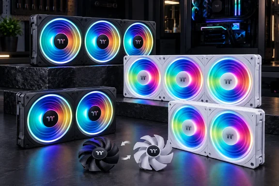

RGB-lit computer cooling fans and radiator assemblies displayed in a dark gaming setup.
Thermaltake has launched the SWAFAN 240 UNIFY ARGB Sync and SWAFAN 360 UNIFY ARGB Sync. They are two- and three-fan units built into one shared frame, they come in black and "snow" (white) editions, and each ships with a second set of blades that turns intake fans into exhaust fans. The press release, published September 24, 2026 and carried by TechPowerUp and APH Networks, pitches two installation benefits: fewer screws and cables, and airflow direction you can change without flipping the whole unit. Thermaltake has built the swappable-blade idea before. What's new here is the fixed multi-fan frame, which cuts wiring and mounting work but also locks you into a set spacing and size. Every airflow, pressure and noise figure below comes from Thermaltake, and no independent test results for UNIFY have been published yet.
SWAFAN UNIFY folds the separate-fan install into one frame​
The main change is physical. Thermaltake's product page says the frame design reduces the number of cables and mounting points, and that assembly needs just a set of cables and four screws at the corners. A standard three-fan radiator setup usually means twelve screws and several sets of fan and lighting leads. Here you secure one rigid unit at its outer corners.
The two model numbers describe the size of the fan bank. According to the Chinese outlet IT Home, the range comes in 240 (2×120) and 360 (3×120) versions, so the 240 has two 120 mm fans in a row and the 360 has three. Those are the usual lengths for 240 mm and 360 mm radiators and top-mounted fan rails. Thermaltake frames UNIFY that way too. When it first previewed the line at CES in January, it said the single-frame structure creates seamless, low-cable fan banks suited for high-end radiators or showcase builds.
Thermaltake doesn't list the exact cable count or connector layout. "A set of cables" clearly means fewer leads than separate fans would need, but it isn't a count, and nothing published so far says UNIFY uses the magnetic daisy-chain connectors found on Thermaltake's SWAFAN EX INFINITY. The CES announcement actually treats them as different approaches. It says SWAFAN EX INFINITY includes magnetic connection for quick connection, and SWAFAN UNIFY features a single-frame structure.
The frame has a clear downside. With separate fans you can space them out, mix sizes, or move one fan somewhere else in the case. A fixed frame needs mounting holes that match its spacing along the whole length. That's normally true of 240 mm and 360 mm radiators and rails, but builders with unusual cases should check before buying. Thermaltake hasn't published case or radiator compatibility guidance for UNIFY.
Swappable blades change intake and exhaust without turning the fan around​
SWAFAN's signature trick carries over. The release says UNIFY comes with standard fan blades pre-installed and reverse fan blades included in the package. The reverse blades are shaped to push air the other way. So a bank facing the same direction can work as intake or exhaust depending on which blades are fitted.
The main reason for this is how the build looks. Fans normally have a "front" side with the lighting and a plain back side with the motor struts. Flip a normal fan to reverse the airflow and you show that plain side. Thermaltake says UNIFY keeps the lighting fully visible in different airflow directions. On a single-frame unit that matters more, because you can't flip just one fan. You'd be flipping all two or three together.
Thermaltake hasn't published a blade-swap procedure for UNIFY, and none is given here. For older SWAFANs, product listings describe it as simple: pop out the fan blades, switch up the blades and press them back in. There's also a maintenance point from independent testing of an earlier model. Reviewing the SWAFAN EX 12 in 2023, Hardware Busters warned that after you remove the fan's blades several times, you will have to lubricate the bearing, which can be challenging if the fan is installed vertically. That finding is about the older fan, not UNIFY. Still, if you swap blades a lot, expect some upkeep, and it's easier to do before the frame goes on a radiator.
The same review questioned how much people actually use the feature. The reviewer said the swappable blades might be innovative, but I am unsure how many will utilize them. The reasoning holds for UNIFY too: the feature helps most when you know you'll use the same fan bank in different roles, for example front intake now and top exhaust after a case change.

UNIFY uses the lighting design Thermaltake introduced across several fan lines this year. The CES announcement lists CT EX INFINITY ARGB, SWAFAN EX INFINITY ARGB, and SWAFAN UNIFY ARGB models, all sharing dual-depth lighting, a 28 mm thick fan body, along with screw-hiding pads. The product page describes the result as a layered effect with two rings on the hub and frame. According to the release, the inner ring is fixed white and only the outer ring can be set to any colour. If you want a fully single-colour build, for example all red, that white inner ring will always be visible.
Lighting runs on standard 5 V addressable RGB (ARGB), which means it plugs into a motherboard's 5 V ARGB header rather than a proprietary controller. The release lists compatibility with ASUS, MSI, GIGABYTE and ASRock sync software. The Snow product page goes further, saying UNIFY supports ASUS, MSI, GIGABYTE, BIOSTAR, and ASROCK sync software. That page also mentions 16.8 million colors.
Plug the lighting into a 5 V ARGB header, not an older 12 V RGB header. The two are physically different and not interchangeable. Neither the release nor the product page gives a board-by-board compatibility list.
The rubber corner pads round out the design. Thermaltake says they cover the four mounting screws to give a smooth surface that makes the lighting stand out. They're purely cosmetic, but they also mean pulling off pads whenever you need to get at the screws.
