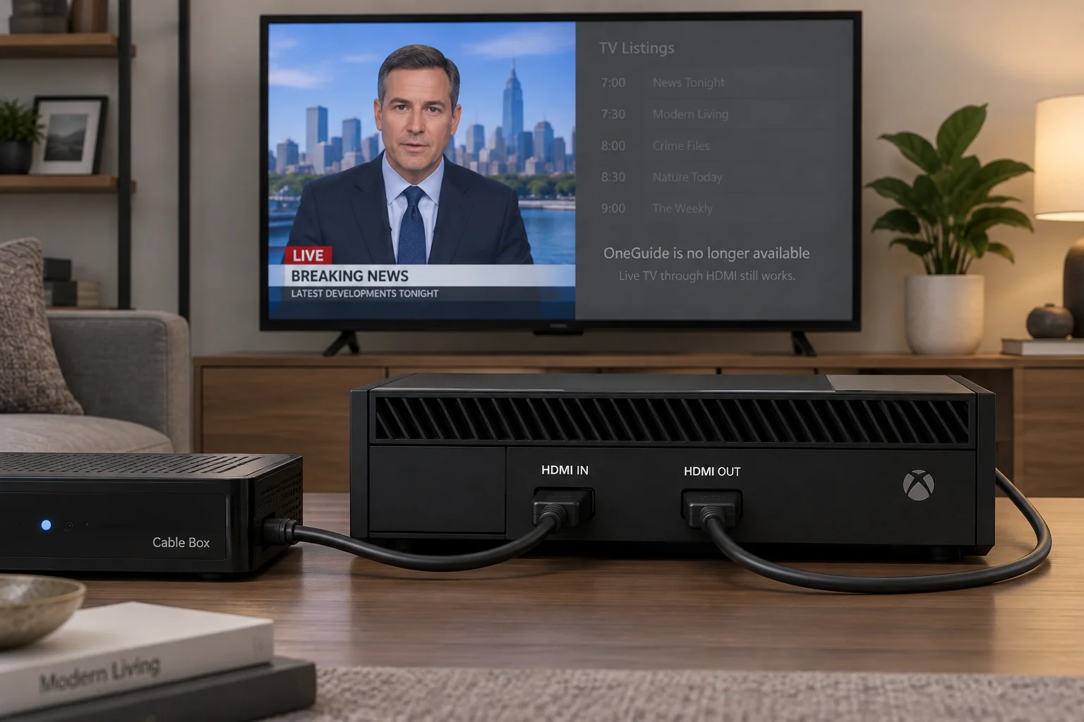

An Xbox connects a cable box to a TV displaying breaking news and a notice that OneGuide is unavailable.
The extra HDMI port on the back of an Xbox One is an HDMI input. It lets another device send its picture and sound through the console to your TV. Microsoft called this feature HDMI pass-through. If you've wondered why your old console has two HDMI ports and your Series X has one, this is the answer.
An Xbox connects a cable box to a TV displaying breaking news and a notice that OneGuide is unavailable. The short answer​
The Xbox One has two HDMI ports with different jobs:
  • HDMI OUT goes to your TV or AV receiver.
  • HDMI IN takes the output of another HDMI device, such as a cable or satellite box.
Microsoft's support page notes that the Xbox Series X|S has no HDMI in port, so you can't connect a cable or satellite receiver to it. The One was built differently on purpose.

The pass-through port was the hardware half of that plan, and OneGuide was the software half. In practice, the Xbox One needed a cable or satellite box connected through the HDMI pass-through to use voice commands and features like OneGuide.
How the connection works​
PCWorld's setup walkthrough describes the basic arrangement. You unplug the HDMI cable that runs from your set-top box to your TV or AV receiver and plug it into the Xbox One's HDMI input. The ports are clearly labeled on the back of the console. Afterward, check that the Xbox's HDMI output is still connected to your TV.

  • Live TV listings were removed. In March 2021, Microsoft announced that as of May 2021 OneGuide on Xbox One no longer supports live TV listings.
  • The HDMI input stayed. Microsoft says you can continue to use OneGuide to view connected HDMI devices or a USB TV tuner. The announcement said OneGuide still works for HDMI pass-through and USB TV tuners, but the on-screen TV listings guide is gone.
So the port wasn't removed from the Xbox One, and it wasn't disabled. What went away was the program guide that sat on top of it. The BGR article calls OneGuide a "glorified HDMI selector" now. That's an informal description, not Microsoft's terminology, but it does reflect what's left.
