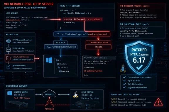

Infographic illustrating a Perl HTTP server command-injection flaw and its patched HTTP::Daemon 6.17 solution.
CVE-2026-8450 is a high-impact reminder that a seemingly routine file-delivery helper can become an operating-system command execution primitive when older Perl semantics meet attacker-controlled input. The flaw affects HTTP:😀aemon versions before 6.17 and centers on send_file, which previously passed filename strings into Perl’s two-argument open behavior. In exposed applications, an attacker-controlled value could be interpreted as more than a path—potentially resulting in command execution, unintended file writes, or disclosure of command output through an HTTP response.
For Windows administrators, developers, and security teams, the key lesson extends well beyond one Perl module. The vulnerability illustrates how legacy convenience syntax, especially in server-side code that handles request parameters, can turn a file path into a control channel. The upstream correction is available in HTTP:😀aemon 6.17, while Linux distributions are also shipping backported fixes for their own packaged versions.

What Went Wrong in send_file​
The danger of Perl’s two-argument open​
Older HTTP::Daemon code used Perl’s two-argument form of open when processing the string supplied to send_file. That older interface combines the file mode and target into a single interpreted expression. Perl’s own documentation describes this style as a legacy form that new code should generally avoid in favor of the three-argument alternative, which separates the mode from the filename.
In particular, Perl documents that one- and two-argument open calls strip leading and trailing whitespace and honor redirection-style characters. This capability, commonly called “magic open,” can be useful in trusted scripts, but it is fundamentally unsafe when a filename is derived from untrusted input. The safer form explicitly supplies read mode and treats the third argument as the literal target.
The vulnerable behavior means the string passed to send_file was not reliably interpreted as “open this ordinary file for reading.” Certain input shapes could instead cause Perl to create a pipe to a subprocess, receive output from a subprocess, or open a target in a write-oriented mode.

The Fix in HTTP:😀aemon 6.17​
Explicit read mode and a literal path​
The upstream remediation changes send_file to use Perl’s three-argument form of open with explicit read mode:
open(my $fh, '<', $file)
The practical security value is that the file path is no longer interpreted using two-argument open shell-magic behavior. A maliciously shaped string is treated as a literal filename; if no file exists with that exact name, the operation fails instead of being converted into a pipe or a write redirection.
This is an excellent example of a secure-by-construction API call. It does not rely on regular expressions to blacklist special characters, guess which command syntax may be dangerous on a platform, or normalize whitespace after the fact. Instead, it selects an interface whose semantics make the intended operation unambiguous.
Perl’s documentation independently supports that approach. It recommends favoring three-argument open over the older concatenated form because separating mode and filename avoids ambiguity, and it specifically advises using the three-argument call for filenames containing arbitrary or unusual characters.
