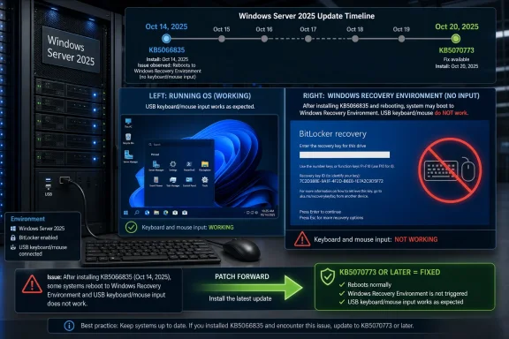

Poster shows Windows Server 2025 update timeline and patch fix: KB5070773 enables keyboard/mouse input during recovery.Microsoft Fixed the Bug, but the Trap Is Still in the Timeline​
Microsoft says the regression arrived with Windows Server 2025’s October 14, 2025 security update, KB5066835, which moved Server 2025 to OS build 26100.6899. After that update, USB keyboards and mice could stop functioning inside Windows Recovery Environment, even though those same devices continued to work normally inside the running operating system.
That distinction matters. A server can look perfectly healthy during routine administration, remote management, patch validation, and ordinary workload checks. The failure only becomes visible when the machine enters WinRE, which is exactly the moment when the administrator has the least room for improvisation.
Microsoft resolved the issue in the out-of-band KB5070773 update released on October 20, 2025, and in later updates. In practical terms, the remediation target is simple: do not leave Windows Server 2025 systems stranded on KB5066835 if those systems may need BitLocker recovery, Startup Repair, reset workflows, or other WinRE tools.
For administrators, the clean check is straightforward. Confirm whether the server is Windows Server 2025, then check whether KB5070773 or a later cumulative update is installed. If the server is still on KB5066835, schedule and apply the newer update through your normal Windows Update, WSUS, Microsoft Configuration Manager, or offline servicing process, then reboot and verify the installed update history.
