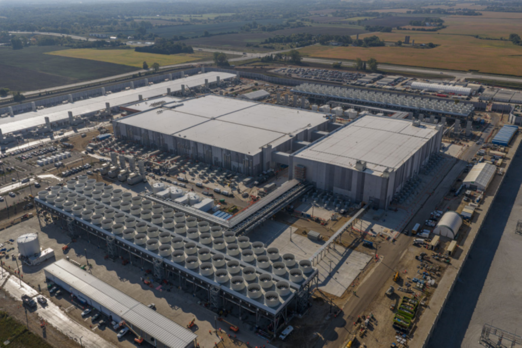

That architecture helped push much of the fleet toward low- or zero-water operation. According to Microsoft, about 90 percent of its 2025 owned datacenter fleet now runs on highly efficient low- to zero-water cooling systems. That is a significant operational baseline, especially compared with the older image of datacenters as buildings that burn electricity to chill air and evaporate water around the clock.
AI changes the problem again. Dense racks of accelerators generate heat in ways traditional air-cooled datacenters were not designed to handle elegantly. The industry’s move toward liquid cooling is not a sustainability branding exercise; it is a physical necessity created by power-hungry chips packed closer together.
Microsoft’s answer is a new AI-optimized datacenter design introduced in 2024 that uses closed-loop direct-to-chip cooling and consumes zero water for cooling during operations. The phrase needs parsing. These systems may use water or other fluid inside the cooling loop, but they are designed not to evaporate water as part of day-to-day cooling.
That shift is important because it breaks the mental link between “liquid cooling” and “continuous water withdrawal.” For IT pros, it also marks a broader architectural transition. Cooling is no longer just a facilities problem; it is becoming part of the compute platform, tied directly to rack density, chip design, workload scheduling, and regional site planning.
But zero-water cooling does not erase the existing fleet. Microsoft still operates a sprawling global estate that includes facilities built across different eras, climates, designs, and ownership models. Some are owned and controlled by Microsoft; others are leased or operated through partners. Corporate sustainability claims often become harder to interpret as soon as the boundary around “our operations” expands or contracts.
