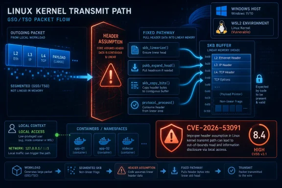

Infographic shows a Linux kernel GSO/TsO transmit-path packet flow with a CVE-2026-53091 vulnerability warning.A Small Header Assumption Becomes a Kernel-Space Security Boundary​
The core of CVE-2026-53091 is deceptively mundane. Some Linux network drivers expect headers for GSO packets to already be present in the linear portion of an sk_buff, the kernel’s central packet buffer structure. The kernel fix changes behavior in qdisc_pkt_len_segs_init() so that instead of merely looking at packet headers through skb_header_pointer(), the code actively pulls the needed header data into place with pskb_may_pull().
That difference sounds microscopic until you remember what kernel networking code does for a living. It is built around fast paths, shortcuts, and assumptions that are reasonable only if every preceding layer has done exactly what it promised. When a driver’s transmit method, commonly exposed as ndo_start_xmit(), assumes headers are already in skb->head, that assumption becomes a contract. If malformed or malicious packets can break the contract, then the next memcpy() is no longer just a copy operation; it is a trust fall.
The CVE description specifically calls out users of net/core/tso.c, where tso_build_hdr() performs a direct copy from skb->data based on a computed header length. In normal operation, that is exactly the kind of hot-path operation the kernel wants: no wasted checks, no extra indirection, no avoidable penalty on throughput. But in security terms, it also means that the shape of the packet buffer matters as much as the packet’s protocol fields.
This is why the fix is not merely a defensive check bolted onto a driver. It moves the responsibility up into common networking code, where GSO packet dissection already happens. The kernel is effectively saying that individual drivers should not each have to rediscover this edge case and reimplement their own partial protection.
