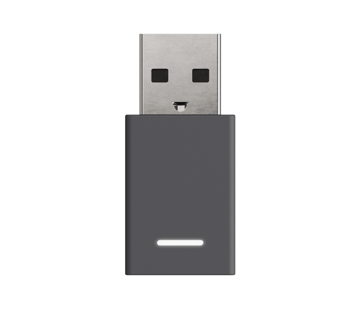

Replacement Unifying Receivers
A compatible replacement receiver can be paired with a compatible mouse or keyboard when both the device and the receiver display the Unifying logo.Both marks matter. Logitech has produced several receivers with similar shapes, so physical resemblance alone does not establish compatibility with the documented Unifying replacement-receiver workflow.
Once both logos have been confirmed:
- Connect the replacement receiver.
- Open Logi Options+.
- Select Add Device or Add Devices.
- Select Unifying Receiver.
- Place the mouse or keyboard into pairing mode.
- Complete the prompts and test the connection.
The six-device capacity applies only to compatible Unifying products. It should not be interpreted as support for pairing arbitrary Logitech wireless devices with any Logitech-branded USB receiver.

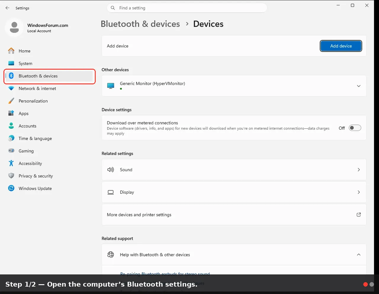

On Windows 11:
- Open Settings.
- Go to Bluetooth & devices.
- Select Devices.
- Open More options beside the relevant device.
- Choose Remove device.
6. Confirm with Yes.
