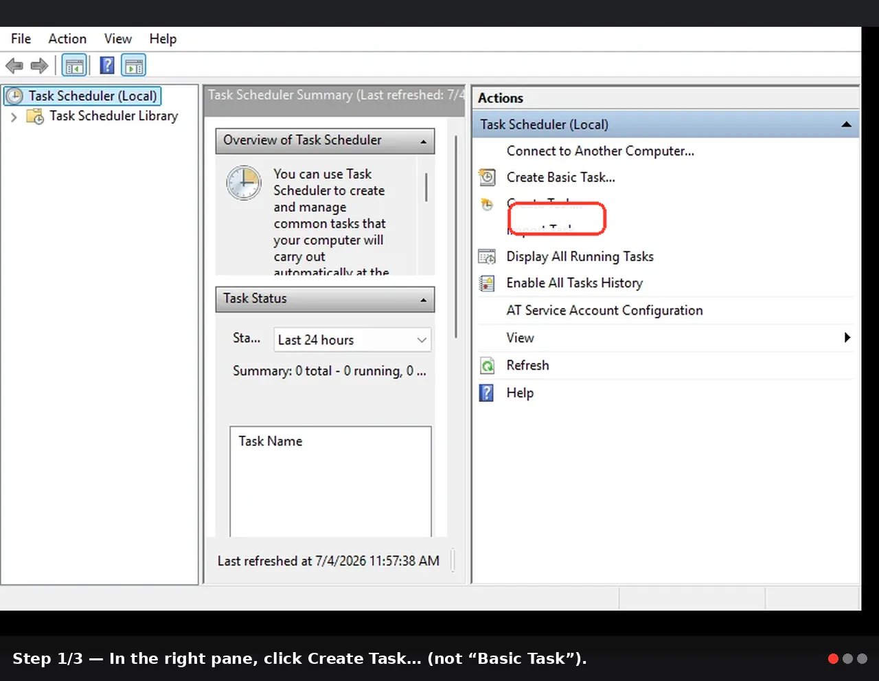

Step-by-step: Part 2 — Auto-connect when you join Wi‑Fi (Task Scheduler)​
We’ll create a scheduled task that triggers when Windows connects to a network.
A) Create the scheduled task​
  1. Press Win + R, type taskschd.msc, press Enter.
  2. Click Task Scheduler Library.
  3. In the right pane, click Create Task… (not “Basic Task”).
B) General tab settings​
