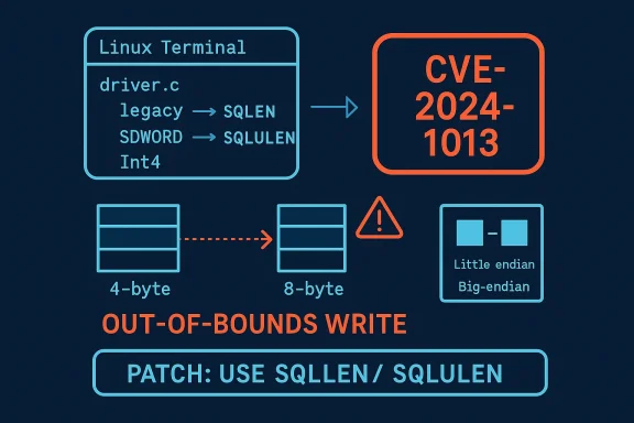

Diagram of CVE-2024-1013: 4-byte to 8-byte conversion leads to out-of-bounds write; patch uses SQLLEN.Background​

The vulnerability is an out‑of‑bounds stack write caused by mismatched pointer-to-integer or integer-type assumptions between caller and callee code. In the affected example PostgreSQL driver code, some variables were declared as older 4-byte integer types while the ODBC API and modern platforms use 8-byte types (for example, SQLLEN) on 64‑bit builds. When the callee writes an 8‑byte value where the stack frame had been allocated for a 4‑byte value, bytes beyond the intended storage are corrupted — producing undefined behavior that can crash the process or, in theory, be leveraged for more serious memory-corruption attacks. The upstream fix replaced the legacy 4‑byte types with the correct SQLLEN/SQLULEN types to avoid the mismatch. (github.com)
Little‑endian vs big‑endian nuance​
A critical detail that makes the vulnerability confusing is endianness. On little‑endian architectures (x86_64, the dominant server and desktop architecture), certain mis‑sized writes may appear to “work” because the overwritten low-order bytes don’t immediately disturb other stack data in an obvious way. Big‑endian architectures may manifest breakage immediately because byte order makes the out-of-bounds writes collide with adjacent fields differently. The upstream notes specifically call out that the bug could go unnoticed on little‑endian systems while being more visible on big‑endian machines. That nuance influenced both the detection timeline and vendor responses. (github.com)
The public timeline and vendor posture​
Upstream: a tiny, deliberate change​
The upstream repository accepted a single small pull request that renames a few variables from legacy integer types (SDWORD, Int4, etc.) to the proper SQLLEN/SQLULEN types used by the ODBC API. The commit diff is three lines of type adjustments in an example driver file (Drivers/Postgre7.1/info.c) and was merged on January 29, 2024; Red Hat Product Security then assigned CVE‑2024‑1013 to the issue. The change is straightforward and targeted — the kind of fix that eliminates the mismatch at the source. (github.com)
