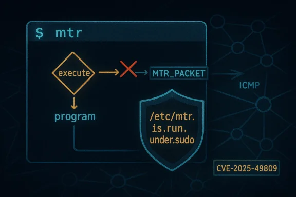

Diagram of a privilege escalation: run MTR_PACKET via sudo to /etc/mtr (CVE-2025-49809).Background / Overview​

What the upstream patch does (technical anatomy)​
Upstream mtr maintainers committed a concise, surgical change to protect against this exact attack vector. The commit message explicitly references CVE‑2025‑49809 and modifies the command execution logic (ui/cmdpipe.c) so that mtr only honors the MTR_PACKET environment variable when it is safe to do so, and provides an administrative opt‑out mechanism that forces the default helper program to be used.
Key points from the commit (paraphrased):
  • The code no longer blindly reads MTR_PACKET in privileged contexts.
  • A simple sentinel file (/etc/mtr.is.run.under.sudo) is introduced as an administrative control: if the sentinel exists, the program refuses to use the environment variable and instead falls back to the default "mtr-packet" helper.
  • The change is small—about a dozen lines—and is specifically targeted to the vulnerable decision point, minimizing the risk of regressions. (github.com)
This approach follows a pragmatic pattern: fix the immediate logic error, then provide admins an explicit, easily auditable flag to force the safer behavior in environments where sudo or non‑setuid operation is used.
