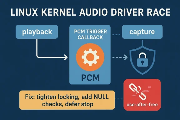

What the Vulnerability Actually Was
The stable patch is unusually direct about the failure mode. The ALSA aloop trigger callback tried to examine one stream and stop the paired stream in the corresponding cable, but those checks and actions were not fully serialized. The result was a window where the code could act on stream state that was already changing underneath it, which is why the fix adds stronger locking around most ofloopback_check_format() and checks for valid substream pointers before proceeding. (spinics.net)Why the race mattered
The important point is not just that a race existed, but that the race could affect a pointer lifetime. The patch note says the issue could result in a UAF when a program repeatedly triggered streams while opening and closing the tied stream. That means the bug was not limited to incorrect audio behavior; it crossed into memory-safety territory, which is why it was treated as a security issue rather than a mere bugfix. (spinics.net)The fix also changes the logic around the capture side. Instead of stopping the capture stream while still inside the hot critical section, the patch records whether the capture stream should be stopped and performs
snd_pcm_stop() afterward. That is a subtle but important redesign: it shortens the time spent under lock while making sure the potentially dangerous state transition happens only after the state has been revalidated. (spinics.net)In practical terms, this is the kind of engineering that kernel maintainers rely on to turn a flaky concurrency bug into a deterministic flow. The code now explicitly checks whether both playback and capture substreams exist, whether their runtimes are live, and whether the capture side is still running before attempting to stop it. That is much safer than assuming the underlying objects will stay stable across multiple calls. (spinics.net)
How the Fix Works
The patch is not a wholesale rewrite. It is a carefully scoped synchronization repair with three main moves: broaden locking in the format-check path, add defensive NULL checks, and separate the “decide” and “act” phases for stopping the tied stream. That kind of surgical change is typical for stable kernels, where maintainers prefer minimal risk fixes that can be backported across supported branches. (spinics.net)Locking the critical section
The first important change is the use ofscoped_guard(spinlock_irqsave, &cable->lock). This effectively ensures the function inspects the relevant substream pointers and runtime fields while the cable state is protected. The patch also tightens access to get_setup() and the card state, which reduces the chance that one thread sees partially updated data while another thread is closing a stream. (spinics.net)The code also adds more robust early returns. If the cable is not valid or the expected playback/capture objects are missing, the function now bails out instead of continuing down a path that could dereference stale memory. These checks are not glamorous, but in kernel code they are often the difference between a recoverable fault and a crashing machine. (spinics.net)
Deferring the stop operation
The second key fix is behavioral: the patch introduces astop_capture flag and postpones the actual stop call. That is a common concurrency tactic because it reduces the amount of work done while a lock is held, and it avoids doing heavy operations in a window where other code may also be touching the same objects. In effect, the code now says, decide under lock, execute outside it. (spinics.net)The final result is a safer trigger path that preserves the driver’s intended behavior while narrowing the race window. This matters because the old code likely behaved correctly most of the time; the bug was in the timing, not in the high-level design. Those are the hardest bugs to catch in testing, and the easiest to dismiss until fuzzing or production load makes them visible. (spinics.net)
