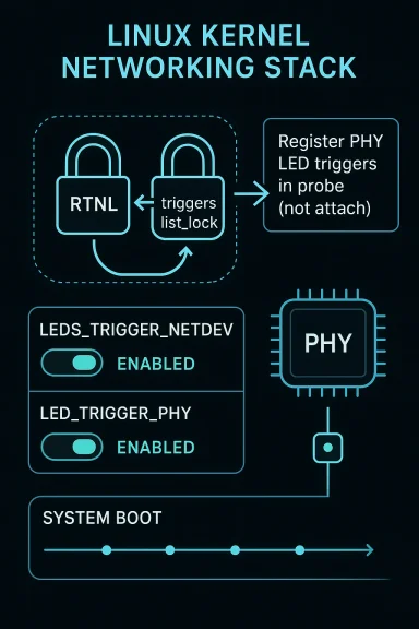

led_trigger_register() while holding RTNL, then tries to acquire triggers_list_lock. The other path does the reverse: the netdev LED trigger activation path holds triggers_list_lock and then attempts to take RTNL. That is the textbook AB-BA pattern that can freeze a system if both sides collide at the wrong time. (spinics.net)What makes this case notable is that the bug was not caused by an exotic exploit primitive or a memory corruption chain. It was a synchronization defect in a hot path that could be triggered by ordinary device-open and LED configuration activity. For administrators, that is often worse than a crashy edge case, because deadlocks feel intermittent, resist reproduction, and can be mistaken for unrelated firmware or driver instability. The kernel patch therefore matters less as a feature change than as a reliability hardening measure. (spinics.net)
What Actually Broke
The failure scenario depends on two features being enabled at once: LED_TRIGGER_PHY, which adds PHY-based LED triggers, and LEDS_TRIGGER_NETDEV, which lets LEDs respond to network-device events. The patch notes explicitly say the AB-BA deadlock occurs when both are enabled, and the stack traces show one side entering throughphy_attach_direct() while the network device is being opened. (spinics.net)The important detail is that phy_led_triggers_register() does not need the RTNL lock at all. The stable patch explains that the helper does not make network-stack calls requiring RTNL protection, and it does not depend on the PHY being attached to a MAC. It only uses
phydev state, which means it can safely move to an earlier lifecycle point. That design observation is the real fix, not merely the code motion itself. (spinics.net)Why AB-BA Deadlocks Hurt So Much
AB-BA deadlocks are pernicious because both lock sequences can look perfectly valid in isolation. Each path acquires one lock, performs what seems like legitimate work, and then reaches for a second lock that another code path already holds in the opposite order. The result is a circular wait that neither side can resolve. In kernel code, that often means an entire device open or configuration operation stalls indefinitely. (spinics.net)In this case, the failure was especially awkward because it involved ordinary user actions. One stack trace shows
dev_ioctl() holding RTNL while opening a device; another shows LED trigger activation from sysfs writing holding triggers_list_lock while trying to enter network-registration logic. That means a networking admin toggling an LED trigger and a device bring-up path could, in the wrong timing window, end up freezing each other. (spinics.net)The practical lesson is familiar to kernel developers but easy to miss in review: lock ordering is part of the API contract. Even when a function appears to “just register some state,” the surrounding lock context can make it dangerous in one call site and safe in another. This CVE is a reminder that subsystem boundaries are logical, not transactional. (spinics.net)
- The deadlock requires both relevant LED triggers to be enabled.
- One path takes RTNL first, then triggers_list_lock.
- The other path takes triggers_list_lock first, then RTNL.
- The bug can manifest during normal device open or LED trigger operations.
- The failure mode is a hang, not a memory corruption exploit. (spinics.net)
The Kernel Fix
The upstream change relocates phy_led_triggers_register() fromphy_attach_direct() into phy_probe(), ensuring the trigger registration happens outside the RTNL-sensitive attach flow. The patch also updates error handling and cleanup paths so trigger registration and unregistration are paired properly in probe and remove paths. That makes the lifetime more coherent and keeps the lock ordering away from the network attach path. (spinics.net)The patch text shows three important structural changes. First, the early call is added during
phy_probe(), where the kernel is not holding RTNL. Second, the corresponding unregister call is moved to phy_remove(). Third, on probe failure the code now unwinds the trigger registration before resetting the PHY. In other words, the fix is not a narrow lock tweak; it is a small lifecycle refactor. (spinics.net)Why Probe Is Safer Than Attach
phy_probe() is the natural place for setup that belongs to the PHY device itself, because the PHY exists before it is attached to a MAC and before the networking path starts manipulating interface state. That matters here because the patch notes explicitly state there is no requirement for the PHY to be attached to a MAC. The triggers only depend on phydev state, so registering them in probe preserves functionality while avoiding the lock trap. (spinics.net)This is also a good example of moving work earlier only when the dependencies allow it. Kernel maintainers often prefer to shrink critical sections rather than merely reshuffling code, and that is exactly what happened here. By pulling registration out of the RTNL-controlled attach flow, the patch reduces coupling between LED trigger setup and network-device state transitions. (spinics.net)
The stable thread shows the fix was attributed upstream to commit
c8dbdc6e380e7e96a51706db3e4b7870d8a9402d and then backported into stable trees. That provenance matters because it demonstrates the issue was recognized as a kernel-wide locking problem rather than a vendor-specific regression. It also signals that downstream distributions should be watching for the backport in their maintenance streams. (spinics.net)- Registration moved from attach to probe.
- Cleanup moved from detach to remove.
- Error paths were adjusted to unregister triggers on failure.
- The fix preserves existing guards for SFP and genphy cases.
- The change is designed to keep RTNL out of the LED trigger registration path. (spinics.net)
