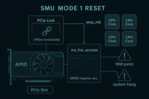

Diagram shows “SMU MODE 1 RESET” with PCIe link offline, no_hw_access, NMI panic, and system hang.Background​

What the Bug Actually Changes​
The patch is conceptually simple: once the reset starts, stop all MMIO access until the device is safely back online. Ubuntu’s description says the driver sets no_hw_access to true right after the reset is triggered, and that other driver threads are supposed to honor that flag and skip register operations while the hardware is offline. That is the core of the fix, and it is exactly the sort of defensive state transition kernel code needs during hardware recovery.
Why MMIO Is the Sensitive Part​
MMIO is the plumbing that lets the CPU talk to device registers through mapped memory addresses. It is fast, direct, and dangerous when the hardware behind it is not in a stable state. During a reset, those registers may stop responding normally, so a read or write that would be harmless a millisecond earlier can suddenly become a transaction that never completes.
That matters because the kernel is not a single-threaded script. Interrupt handlers, work queues, display code, and power-management callbacks can all be active at once. If just one of them ignores the reset window, the driver can trip over its own recovery logic.
The Role of the Memory Barrier​
The addition of smp_mb() is not decorative; it is there to enforce ordering. In a concurrent kernel, it is not enough to update a flag in one CPU’s cache and hope every other core notices immediately. The barrier helps ensure the no-hardware-access state becomes globally visible before the driver enters the sleep or wait phase described in Ubuntu’s advisory.
That detail makes the fix more robust than a narrow “set a boolean” patch. It addresses the race between the state change and the rest of the driver observing that state, which is where real-world hangs often come from. In kernel terms, this is the difference between a polite warning and a believable guarantee.

Why the GPU Becomes Temporarily Unreachable​
During the reset cycle, the ASIC can become unavailable over PCIe. That is what makes the bug possible in the first place. If a background thread or interrupt-driven callback touches the hardware while it is unreachable, the PCIe transaction may never complete cleanly, leaving the kernel waiting on a dead response.
This is not merely a cosmetic issue. In a desktop environment, the display engine may be involved. In a workstation or compute host, the GPU may be part of a larger service chain, so one hung device can ripple into failed jobs, broken sessions, or watchdog resets. The blast radius is often larger than the patch size suggests.
