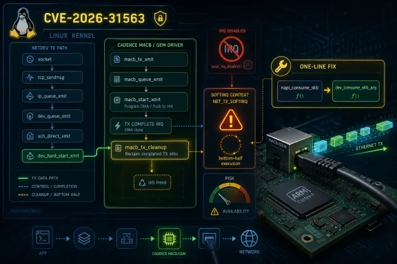

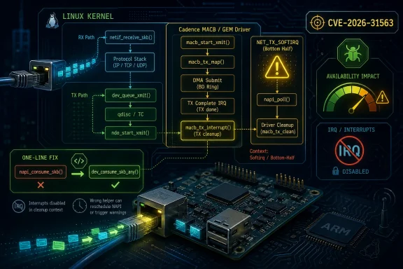

Diagram of a Linux kernel network driver TX path with IRQ disabled warning and a one-line fix.Overview​
CVE-2026-31563 concerns the Linux kernel networking driver known as macb, used for Cadence MACB and GEM Ethernet controllers found across embedded and system-on-chip platforms. The reported fix changes the transmit cleanup path so that TX socket buffers are released with dev_consume_skb_any() rather than napi_consume_skb().
That sounds deceptively small, but the kernel call context matters enormously. napi_consume_skb() is designed for NAPI processing expectations, while the affected code path began freeing TX SKBs with IRQs disabled after an earlier locking fix. The result was a kernel warning in the softirq path, with the trace pointing through skb_attempt_defer_free(), napi_consume_skb(), and macb_tx_poll().

The immediate issue is that the MACB transmit cleanup path was calling a helper that assumes a different execution context. In the Linux networking stack, freeing a socket buffer is not just a memory-management detail; it can interact with deferred freeing, softirq state, and per-CPU networking behavior.
The visible symptom in the report was a warning from __local_bh_enable_ip(), indicating that the kernel was unhappy with bottom-half handling while processing softirqs. The call trace showed the path through ksoftirqd, making this a classic Linux networking timing and context problem rather than an obvious user-space crash.
The One-Line Fix With Outsized Meaning​
The patch replaces one SKB release helper with another. That may look like a cosmetic API cleanup, but in kernel networking, choosing the wrong helper can create unstable behavior under interrupt or softirq constraints.

The Technical Root Cause​
The vulnerability description points to an earlier change identified by the title “net: macb: Fix tx_ptr_lock locking.” After that change, freeing TX SKBs occurred while IRQs were disabled. The driver still called napi_consume_skb(), which was not intended for that context.
This is a subtle category of bug because the driver was not obviously dereferencing a bad pointer or copying past the end of a buffer. Instead, the code violated a kernel API contract. When networking traffic exercised the path, the kernel emitted a warning through the softirq machinery.
NAPI, SKBs, and Context Rules​
NAPI is the Linux networking mechanism that reduces interrupt overhead by shifting packet processing into scheduled polling. It is central to modern Linux network performance because it prevents a device from interrupting the CPU for every packet during heavy traffic.
SKBs, or socket buffers, are the kernel’s core network packet containers. They carry packet data and metadata through the stack, from drivers to protocols and back again. Freeing them at the wrong time or in the wrong context can create warnings, stalls, or worse.
The important distinction is this:
  • A network device completes packet transmission.
  • The driver’s TX cleanup code releases resources tied to that packet.
  • The SKB must be consumed or freed using a helper appropriate to the current execution context.
  • If interrupts are disabled, the helper must not assume it can safely perform operations that rely on a different bottom-half state.
  • The corrected helper, dev_consume_skb_any(), is designed to be safe across more contexts.
That fifth step is the patch’s entire point. The fix does not redesign MACB networking; it aligns the driver with the kernel’s context rules.
