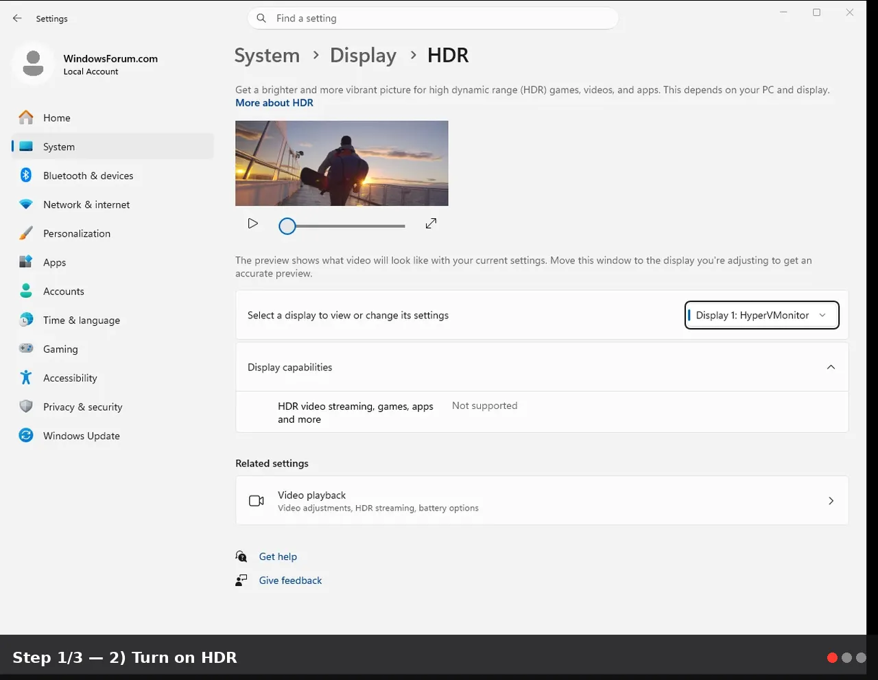

2) Turn on HDR​
  1. Go to Settings → System → Display.
  2. Select your HDR display.
  3. Click HDR.
  4. Toggle Use HDR to On.
Warning: Turning on HDR can change how the Windows desktop looks (sometimes dimmer or different color). That’s normal—Windows is switching to an HDR output mode.
