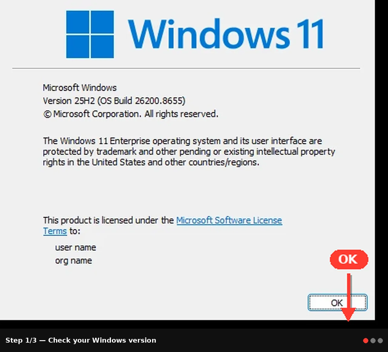

Check your Windows version​
  1. Press Windows key + R.
  2. Type:
    winver
  3. Select OK.
  4. Look for the Windows version number in the dialog box.
If you are on an older Windows 11 release and do not see the setting described below, install the latest Windows updates first.
