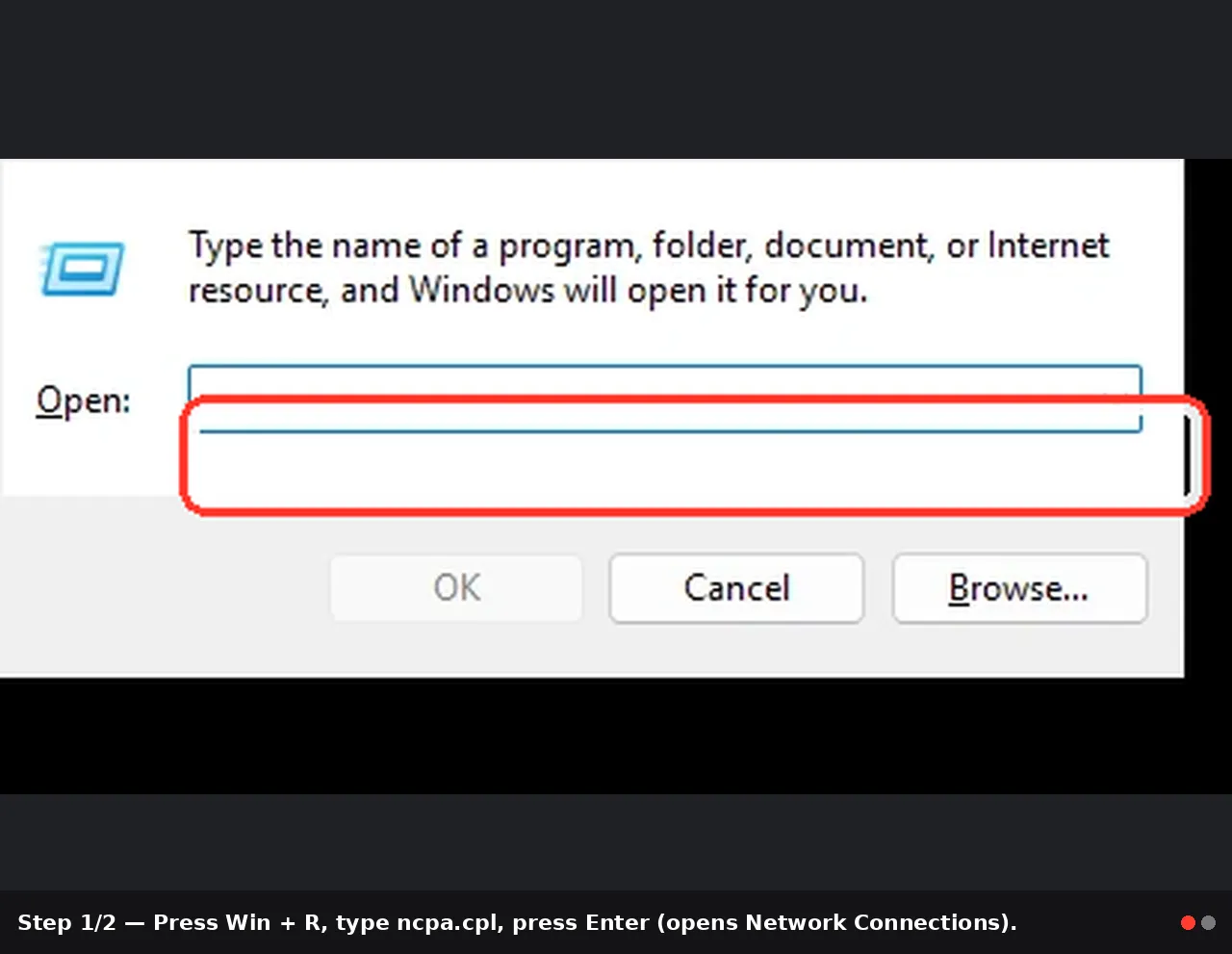

  • Press Win + R, type ncpa.cpl, press Enter (opens Network Connections).
  • Right-click EthernetDisable. Wait 5 seconds.

Windows Run dialog with ncpa.cpl typed in the Open box.
