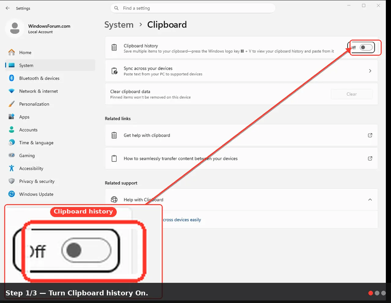

1) Confirm Clipboard History Is Enabled​
  • Open Settings:
  • Windows 11: Start > Settings
  • Windows 10: Start > Settings
  • Go to:
  • Windows 11: System > Clipboard
  • Windows 10: System > Clipboard
  • Turn Clipboard history On.
  • Press Win + V to test.
Windows 11 Clipboard settings page showing the Clipboard history toggle and clear clipboard section.
