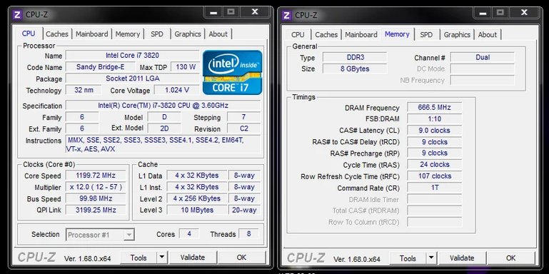

    I've ran previous CHKDSK's before, and the last one was about 3 days ago. Ran the GPU Burner for 25 minutes, no problems.
    I also tried to bring my clock as close as I can remember to how it was Day 1. Doesn't look like there is an easy option to bring it to 'Default.'
    Going to play some Planetside 2 for the rest of the day (or to a BSoD) and post back here within 48 hours of how it's going.
