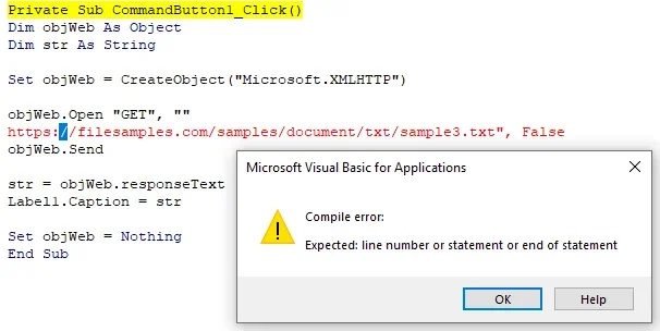

Bob07984
Active Member
Aug 28, 2021
12
Hello, thanks for the suggestion 👍
However, when i try and use this code, i get the following error (Shown in screenshot)
I have tried to debug the code I.E i have changed the URL, added a comma here and there, added quotation marks here and there, tried a few semicolons, etc, however with no success.
As i said, when it comes to VBA my understanding really is limited, i suspect a small typo somewhere?
Thanks a lot though...
****EDIT - I have just looked through your code on the forum once again, and noticed it did not quite match the code i had pasted into my VBA editor, so i have copied and pasted again, and am getting more luck this time - i guess something got a bit muddled up during me transferring the code into excel, my bad. Seems to be working as intended now, thanks a lot! ****
