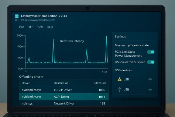

Laptop screen running LatencyMon with a latency graph and driver table.Background / Overview​

In the hands‑on account that kicked this back into the headlines, LatencyMon highlighted two repeated offenders: the NVIDIA kernel‑mode driver and an ACPI/power management module.
Why those two matter:
  • GPU kernel drivers can schedule expensive DPC work (for interrupt handling, context switching, or driver bookkeeping). On many systems, graphics driver bugs or misbehaving driver versions show up as high DPC peaks. That causes frame‑time spikes and can affect unrelated subsystems (audio or USB).
  • ACPI and OEM power management modules control CPU power states, throttling, and platform thermal/power policies. Aggressive switching into very low power states (or buggy interaction with OEM thermal drivers) can introduce latency when the CPU must wake or when platform drivers run at high IRQL. If ACPI shows up in LatencyMon, it usually points to power‑management interactions rather than a bad Bluetooth headset.
In the case study, the user made conservative, reversible changes focused on platform power management that traded some battery life for stability:
  • Increased the minimum processor state in the Windows power plan (so the CPU spends less time in the deepest idle states and switches states less aggressively).
  • Disabled **PCI Express Link State Power devices, including GPU links or Thunderbolt bridges, don’t enter L0s/L1 aggressively).
  • Disabled USB Selective Suspend and unchecked “Allow the computer to turn off this device to save power” for affected USB/Bluetooth hubs in Device Manager.
Re‑running LatencyMon after these changes removed the large DPC spikes and the system stopped freezing. This is a textbook example of diagnosing root causes with measurable evidence instead of trial‑and‑error.

  • Read modules with the largest highest execution time or highest cumulative DPC/ISR time. Note exact file names (e.g., nvlddmkm.sys).
