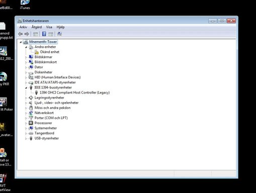

The FW legacy driver problem was corrected early.

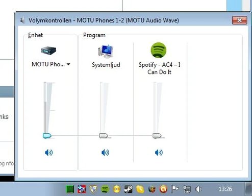

I can't understand where the signal is boosted? As described in my initial post it feels like the stereo signal out from the computer is boosted 2 or 3 times before going out ... I am now playing spotify through the MOTU card but have to have both the MOTU slider and the Spotify slider at 4% in the Win 7 sound mixer ... and I also have noise together with the music suggesting the volume was maxed out ...
So my n00b conclusion is that somewhere the signal is boosted but I don't know where ...

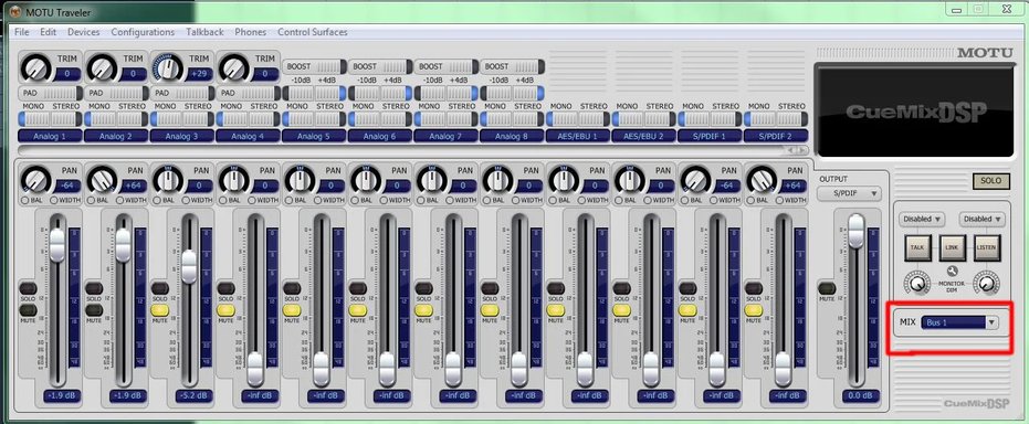

In Cuemix, in the bottom right hand corner, there is a mix dropdown button to change the bus. Go to all the buses you aren't using and use the mute button next to the output slider, to mute them. You're probably only using 1, so if this is the case, mute buses 2 , 3 and 4.
If you say this doesn't help out, I may have other things to try.

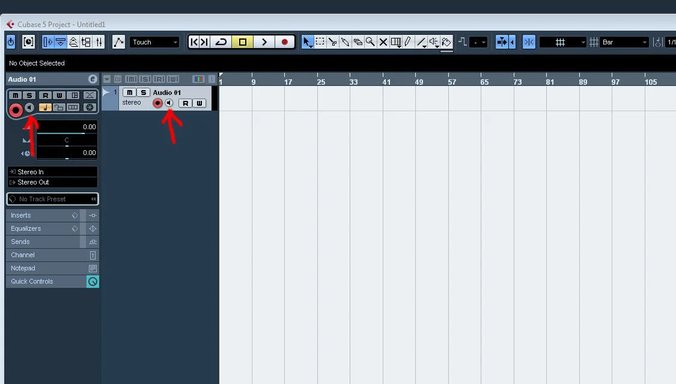

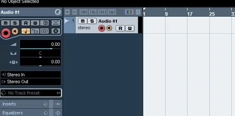

I thought of something else that should help. In Cubase, you can set the tracks to be monitored or not. If you're monitoring in Cubase and also with Cuemix, that will double the sound which you don't want.
If you click either of the places the arrow shows in the track, that's the monitoring button. The first screenshot it with monitoring off and the second is with it on.
