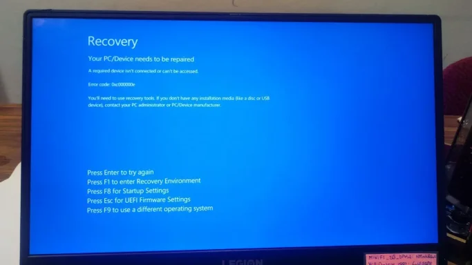

Hello, I bought an SSD nvme to add to the HDD of my wife’s Legion Y530-15ICH. The computer had a Windows Home installation gone bad after an update, as it was only producing a black screen.
So, I installed Windows 11 after downloading it from the Microsoft website, I managed to log in and retrieve the access, I get notified of the updates available, and start with the first one.
Upon the necessary reboot, guess what? New black screen.

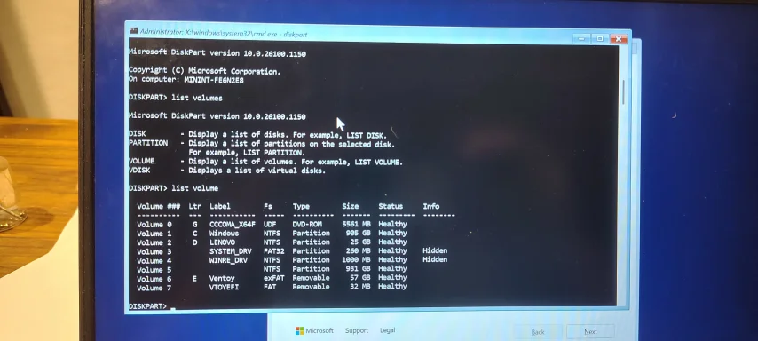

First on the Linux Terminal, but it didn’t work out, giving again the "There is an error selecting this partition for install" error.
I tried then within cmd.exe during the installation, but I wasn’t able to solve anything, having again the same error prompted.

The screen shows multiple Windows 11 OS options in the Startup Repair menu on a Legion laptop.

2. Prep Both Drives (Wipe from Windows Installer)​
  1. Boot with the Windows 11 USB installer.
  2. When you get to the partition selection screen, press Shift + F10 to bring up the Command Prompt.
  3. Type diskpart and press Enter.
In diskpart:​
  • List your drives:
    list disk
  • Select the NVMe and HDD one at a time (replace X with disk number):
    Code:
    select disk X
    clean
    (Do this for both SSD and HDD if you want both completely blank.)
  • Create GPT partition table (recommended for modern UEFI systems):
    convert gpt
  • Exit diskpart (exit).

thanks after doing so, the installation finally started but at a certain point halted, with this blue screen:

That error screen (0xc000000e) means Windows can't locate the necessary boot device or boot files. It usually points to:
  • Missing/incorrect BCD entries.
  • Corrupt or missing EFI boot files.
  • Windows setup not finding the right EFI/System partition.
This is common after BCD cleanup or moving between drives. Here's a step-by-step recovery:
1. Boot from Windows 11 Installation USB
  • Start your computer and boot from the USB Windows installer.
2. Open Command Prompt
  • At the "Install Windows" screen, press Shift + F10.
3. Rebuild Boot Files
a) Identify Windows Install​
Type these commands (press Enter after each):
Code:
diskpart
list volume
exit
Look for your Windows SSD's letter, e.g. C: or D:.
b) Rebuild EFI Boot Files​
Suppose your Windows partition is C: and the EFI partition is, say, S: (EFI is always a small, 100–500MB FAT32 partition):
First, assign a letter (if it’s not already there):
Code:
diskpart
list disk
select disk 0  (pick your system disk)
list partition
select partition X   (pick the small, FAT32 EFI partition)
assign letter=S
exit
Now, run:
bcdboot C:\Windows /s S: /f UEFI
(Change C: and S: as needed for your case.)
This command reinstalls the boot files for your current install.
4. Restart
  • Remove the installer USB and boot normally.
If you still get 0xc000000e:​
  • There may be leftover or corrupt boot entries. You can use:
    Code:
    bootrec /scanos
    bootrec /rebuildbcd
    bootrec /fixboot
    (If “Access is denied” on bootrec /fixboot, let me know.)
What is likely happening?​
After BCD manipulation or system wipe, the boot files can point to the wrong place or simply not exist. bcdboot re-copies and recreates what’s needed for UEFI boot, almost always fixing this error unless the hardware or file structure is still off.
If you get stuck on finding which partition is which, or if Windows won’t appear at all, let me know! A quick photo of diskpart list volume or the Windows drive letters will help me guide you exactly.
You’re close—this step fixes most post-partitioning blue-screen boot errors!

Thanks, this is the list of volumes

Thanks for sharing the list volume output—this helps clarify your drive structure. Here’s a breakdown and the next steps for repairing your boot:
Volume List Explained
  • Volume 0: USB installation media (ISO), UDF.
  • Volume 1: C: – Your main Windows partition (905 GB, NTFS).
  • Volume 2: D: – Likely a recovery or OEM partition (25 GB, NTFS, labeled LENOVO).
  • Volume 3: SYSTEM_DRV – 260 MB, FAT32, Hidden. This is likely your EFI System Partition (ESP).
  • Volume 4: WINRE_DRV – 1000 MB, NTFS, Hidden. This is likely your Windows Recovery Environment partition.
  • Volume 5: Another drive, likely an HDD with data (931 GB, NTFS).
  • Volume 6/7: Ventoy USB stick (exFAT/FAT).
How to Rebuild Boot Files With This Layout
1. Assign a Letter to the EFI Partition (if it's not already assigned)​
Since SYSTEM_DRV is the EFI partition, let's assign it the S: letter:
Open Command Prompt from the installer and run:
Code:
diskpart
select volume 3
assign letter=S
exit
2. Use BCDBOOT to Rebuild Boot Files​
Now, back at the prompt, run:
  • This copies the correct boot files from your Windows install (C:\Windows) to the EFI partition now mounted as S:.
3. Remove Installation Media and Reboot​
  • Exit Command Prompt, remove any USB installation/drives, and reboot your PC.
Notes
  • If Volume 5 (931 GB, NTFS) is a second drive, you don’t need to do anything with it—focus on the EFI/System/Windows partitions for boot repair.
  • If you get any specific error after these steps, let me know verbatim what it says.
You are very close! Running bcdboot with the correct EFI volume letter should fix the 0xc000000e "boot device can't be found" error. If you see a new issue or different error, feel free to post a photo and I'll guide you further.

Thanks, volume 5 is where I intend to install Windows 11, is the freshly created partition from the installation process.
It wouldn't hurt to fix the original installation in the process, though
Ah, thanks for clarifying! If Volume 5 (931 GB, NTFS) is your freshly created partition and the target for the new Windows 11 install, here’s how to approach it:
Correct Boot Repair Steps for Installing Windows 11 on Volume 5​
1. Confirm the EFI Partition to Use​
Your system already has an EFI partition (SYSTEM_DRV, 260 MB, FAT32, likely Volume 3). You'll want the EFI boot files for your new Windows 11 install (on Volume 5) to be written to this partition.
2. Assign Drive Letters (if needed)​
If not already assigned:
Code:
diskpart
select volume 3   (EFI partition, SYSTEM_DRV)
assign letter=S
select volume 5   (your new Windows, 931 GB)
assign letter=W
exit
Now, your new Windows partition is W: and the EFI partition is S:.
3. Write Boot Files for New Windows​
From Command Prompt, run:
bcdboot W:\Windows /s S: /f UEFI
This command copies the necessary EFI boot files for the Windows install on W: to the EFI partition S:.
4. (Optional) Tidy Up BCD​
This will add the new Windows install to your UEFI boot menu.
  • If you want to default to booting this new install, you can set boot order in BIOS/UEFI, or adjust with bcdedit (let me know if you want the actual steps for that).
  • Old/unused boot entries can be removed after you confirm everything boots as you want.
5. Reboot​
Close Command Prompt, remove installer media, and reboot. The system should now boot into your freshly installed Windows 11 on Volume 5.
Regarding "Fixing the Original Installation"
If you want to also repair the boot files for the original install (probably on Volume 1, C:):
This will add both installations to the boot menu. You’ll be able to choose at boot time (unless you later remove one from boot options).
Summary/Best Practice
  • Use bcdboot specifying the right Windows source folder and EFI partition letter.
  • Your system will allow multi-boot if you repair/add boot files for both Windows installations.
  • Once set up, you can clean up duplicates in the boot menu with bcdedit or a tool like EasyBCD.
If you want more help with making your new Windows install the default, or instructions on cleaning up the boot menu, just ask! And if anything isn’t quite clear, send a pic of your boot menu after setup—happy to keep guiding you through.

Thanks, at this point I guess I can assign letter W to volume 1, and C to volume 5, where likely it will be the forever install, the other one will be forgotten over time. Right?
Yes, exactly! During the setup or while in the Windows installer’s command prompt, you can assign any available drive letters to your volumes as you see fit. This won’t affect the final drive lettering after installation—Windows will typically assign C: to the system partition it boots from.
What you suggested:
  • Assign W: to the old Windows volume (Volume 1).
  • Assign C: to the new Windows installation volume (Volume 5, your intended permanent install).
  • Use these letters accordingly with bcdboot for boot repair, for example:
(for the new install)
If you want to add the old install to the boot menu “just in case,” you’d use:

Unfortunately the blue screen with the error eventually always appear, also after having assigned the letters.
At this point, if I do diskpart, select disk 0, clean, convert got; select disk 1, clean, convert got; recreate the partitions and formatting them within the installation process, I should no longer encounter problems, right?
Thanks
Given the persistent blue screen (0xc000000e) even after repairing boot files and assigning letters, you’re absolutely right:
A fresh start is often the cleanest and least stressful path forward.
