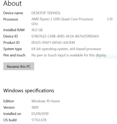

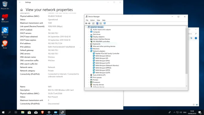

Screen shots of device manager would help us a lot in solving this as well as machine make and model.
The computer in question is a desktop PC.
The router is a few years old now, but I don't recall exactly when I got it.
From what I understand about the devices listed in the device manager, the PC does have a wireless card installed.
In the attached files are screenshots of the information you asked for. I did make sure the drivers for all the networking devices are up to date.

If you like to connect via Wi-Fi then you maybe need a Wi-fi dongle, the yare cheap and easily connected to any USB connector on your computer..
