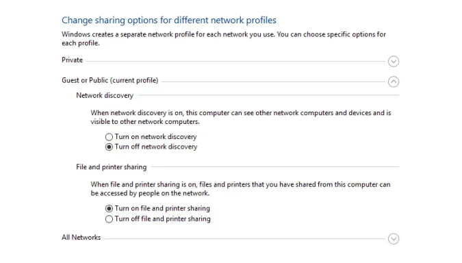

I have my Windows 10 Pro computer to connected to cable modem via Ethernet. I am not using Wi-Fi, just Ethernet only.

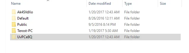

I discovered two folders that I have not seen before. I deleted the folders and tried to turn off file sharing. I clinked to save changes and looked at the file explorer and file and printer sharing in under public user is still enabled. The folders still showed up. I am not on any network. I have changed the cable modem password a month ago. I am not on any home network.

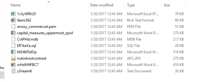

If you look at the folder with various small files, I am unable to open any of these files. I have Kaspersky Internet Security, Malwarebytes, Spy Bot 2 and Cybereason RandomwareFree. I did all scans and my hard drive is clean. Why do I have a network drive A:?
A: is disabled in BIOS since I have no floppy drive. Network discovery is turned off, not enabled. No one else is using my desktop computer.

@trstick1: Since your PC or laptop is directly connected to the Cable Modem via Ethernet, you don't have a network (LAN) by strict definition, however you are on an internal network created by the Cable Modem. This can be enabled even without a physical router box, as there is an internal network connection for 1 computer on your Cable Modem which is the Ethernet port. Make sure that you do not have W10 Homegroups enabled. If you do, unjoin your computer from it, reboot and look at your Network sharing settings again. Most likely that will correct it and turn off that setting. :up:

Found out why l am getting the disconnected network drive and those 2 folders in the user account. I installed a free program that detects any Randomware and it created the network drive as an additional method for detecting ransonwware. The application is RansomFree by Cybereason.

Just saw this post today. Yup these random folders are created by CyberReason. They are ransomware honey pots. If you delete them CR will just recreate them.

i had seen this post only today also … if i were trstick1, i'd ask cybereason if they placed that a:\ directory key inside the registry. honey-pots are utilized is for ransomware to land upon those files first. while ransomware is encrypting those files, cybereason has chance to stop the attack on valid and important files. "a" is first letter of the alphabet … logically, ransomware would start at this drive. anyway … that's about all i know.

I did contact Cybereason. They told me that they use the A: as a network drive as a way to catch randomware so that randomware won't attack the c: primary drive.

I do not have homegroup enabled. The cable modem is supplied by the cable/internet provider. I have it setup so that nobody can use my WiFi without a strong password I created for it.
