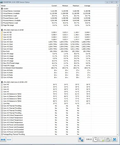

I updated the driver. I also downloaded the tool as recommended, i will upload the status from the tool as well.

thanks for the temps upload. On the second screenshot you've highlighted a temperature:
AUXTIN is the power supply temp sensor if there is one. See if you can see the fan spinning inside the PSU as well as feeling the PSU casing to see if it's running hot.
Can you post some information on your system such as CPU, GPU, HDD, RAM plus the make and model of your PSU. Thanks.. :)
Whats the airflow like in your case?
Hi,

Hi,
apologies as thought I'd replied.
Regarding your above screenshots: Looks quite dusty in there which could be cleaned out plus that rat's nest of cabling ideally needs to be sorted out a little better. There's usually somewhere that you can route a cable and i spend quite a bit of time getting this right as it will increase airflow and look prettier.
You could try testing for those temps again but this time keep the side panel off. If this makes a big difference in those temps then you know what your culprit is...
I agree with your already large CPU Heat Sink you could clear that path of air from your front fan- to-rear airflow and should make a pretty substantial difference. See what that does for you.
