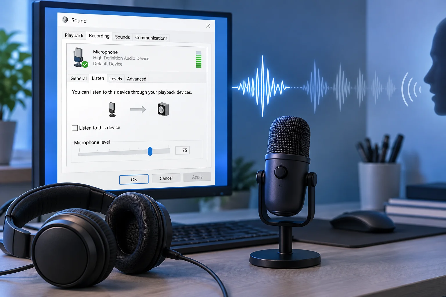

A desktop microphone and headphones sit before a monitor displaying Windows microphone settings and a sound wave graphic. Identify Which Type of Microphone Echo You Have​

Turn Off "Listen to this device" to Stop Hearing Yourself​
When you hear your own voice echoing through your speakers or headphones even when no call or recording app is open, Windows is actively monitoring the microphone endpoint. While the modern Settings app controls basic volume, the playback monitoring toggle resides in the classic Sound Control Panel (mmsys.cpl) in both Windows 10 and Windows 11.
  1. Press Win + R on your keyboard to open the Run dialog box.
  2. Type mmsys.cpl and press Enter (or click OK) to open the Sound window directly.
    • Alternative path in Windows 11: Open Start > Settings > System > Sound, scroll down to the Advanced section, and click More sound settings.
    • Alternative path in Windows 10: Open Start > Settings > System > Sound and click Sound Control Panel under Related Settings on the right side (or bottom) of the window.
  3. Click the Recording tab at the top of the Sound window.
  4. Locate your active microphone (marked with a green checkmark labeled Default Device or Default Communications Device). Right-click the microphone and select Properties.
  5. Select the Listen tab in the Microphone Properties window.
  6. Uncheck the box next to Listen to this device.
  7. Click Apply and then OK to save the change immediately. No system restart is required.
  8. If you have additional microphones connected—such as a webcam microphone, a headset microphone, and a built-in laptop array—repeat steps 4 through 7 for each enabled recording device on the Recording tab. A secondary microphone left in listening mode will continue to feed room noise into your speakers even if it is not your default input.
