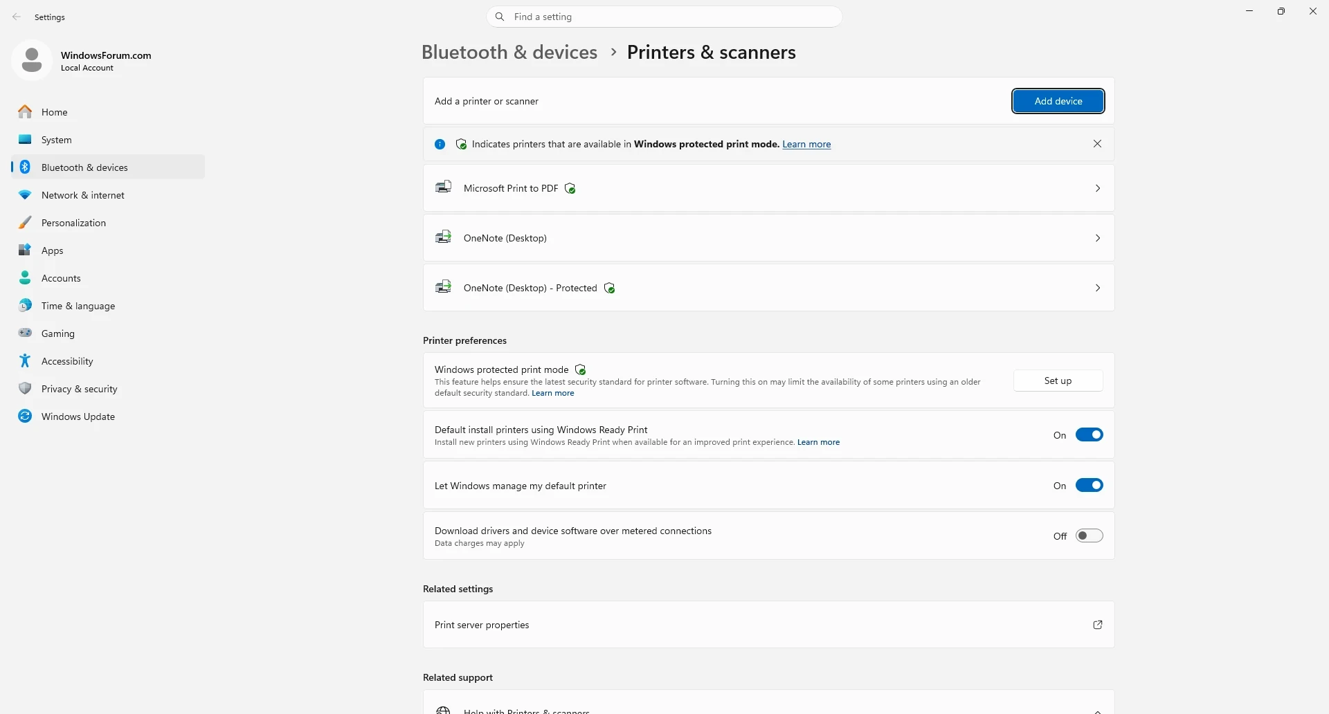

On Windows 11​
  • Press Windows key + I to open Settings.
  • In the left sidebar, select Bluetooth & devices, then click Printers & scanners.
  • Click the name of your printer in the list to open its management page.
  • Click Print test page near the top of the window (or click Printer properties and select Print Test Page at the bottom of the General tab).
Settings shows the Printers & scanners page with the Add device button and the installed printer list for managing or removing printers.
