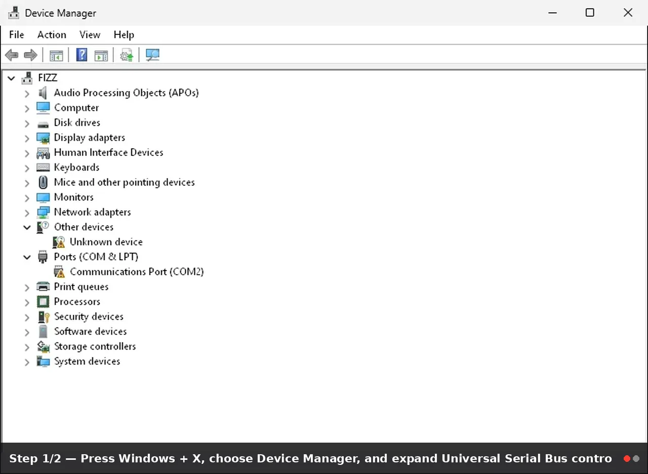

Quick walkthrough
  • Connect the wired controller you actually use for gaming.
  • Press Windows + X, choose Device Manager, and expand Universal Serial Bus controllers.
  • Look for entries such as USB Root Hub, Generic USB Hub, USB Hub, or SuperSpeed USB Hub. The exact names vary by chipset and Windows driver.
  • Right-click one hub, choose Properties, and open the Power Management tab.
  • If you see Allow the computer to turn off this device to save power, clear the checkbox and select OK.
  • Repeat only for other USB hubs that could be serving the controller, then restart Windows or unplug and reconnect the controller before testing.
Device Manager showing the computer's hardware device categories in a tree.
The difficult part is identifying the correct hub. A desktop can have several independent USB controllers and hubs, while a laptop may expose fewer visible branches. Do not blindly disable the setting on every entry unless you have exhausted a targeted test; doing so can increase idle power use and may leave more peripherals powered when the PC is running on battery.
A practical beginner method is to change one likely hub at a time. Start with the hub corresponding to the physical port in use, restart or reconnect the controller, then reproduce the idle period that normally triggers the fault. If nothing changes, restore the checkbox and test another hub. This preserves a clear record of what actually helped.
Some controllers also appear under Human Interface Devices, Xbox Peripherals, Sound, video and game controllers, or a vendor-specific category. Check their Properties windows as well. If a controller entry has a Power Management tab with the same power-saving checkbox, clear it for that controller. If the tab does not exist, leave it alone; forcing registry edits to create or alter hidden device power policies is not an appropriate first-line fix.
Microsoft’s driver documentation makes the reason clear: a driver can decide which power options it exposes to users. The missing checkbox does not mean Windows is ignoring the controller, nor does it prove that power management is the problem.
