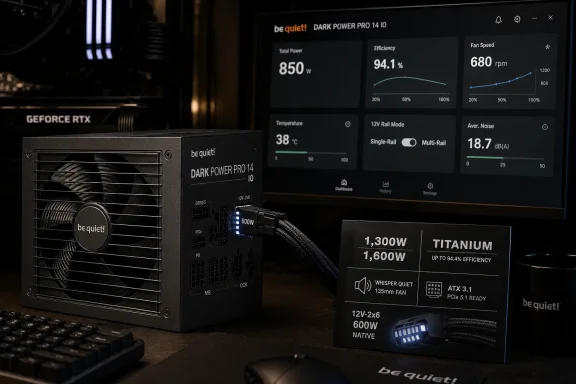

The software is the real product change
The Dark Power Pro 14 IO is be quiet!’s effort to turn the PSU from a sealed, set-and-forget component into an addressable system device. IO Center is expected to display live power, efficiency, current, voltage, fan behavior, and operating time; XiaomiToday also says the application includes an electricity-cost estimate.
Monitoring alone is not especially consequential. Motherboard telemetry, GPU utilities, smart UPS units, and wall meters already give enthusiasts several ways to see system draw. The material change is control: users can reportedly select active or semi-passive fan operation and switch between single-rail and multi-rail 12V modes inside the application.
That replaces the physical overclocking key used on older Dark Power Pro models. Lab501’s Computex coverage specifically described the new design as moving fan controls, rail selection, and monitoring from physical controls into IO Center. For builders who mount a PSU in a shrouded case, software access is plainly more convenient than opening the chassis or routing an external switch bracket.
Convenience is not a reason to leave the setting on its most aggressive option, however. Multi-rail mode divides 12V delivery into separately protected rails, allowing over-current protection to intervene on an individual rail. Single-rail mode pools that delivery into one high-current 12V source. That can be helpful for extreme overclocking or unusual hardware loads, but it also removes a layer of segmentation that multi-rail operation provides.
For a conventional one-GPU gaming or workstation PC, buyers should start in multi-rail mode and only change it when there is a documented compatibility or protection-trigger issue. The availability of a software toggle does not make single-rail operation the default best choice.

be quiet! has promoted both 80 Plus Titanium and Cybenetics Titanium certification, though published coverage from the Computex announcement described efficiency of up to 94.0%, while XiaomiToday now reports up to 94.9%. That difference is small in practical use but worth flagging: the higher figure has not appeared consistently across the earlier coverage.
Cybenetics’ independently published page for the Dark Power Pro 14 IO 1600W confirms that the unit reached its Titanium classification and identifies a 135mm fluid-dynamic-bearing Silent Wings fan, fully modular cabling, and semi-passive operation. The lab received the sample on May 11 and tested it on June 9, before be quiet!’s Computex presentation. In other words, the 1,600W model is not merely a rendered product page or a late-stage announcement; a production-identifiable sample has passed through third-party PSU testing.

ATX 3.1 and 12V-2x6 solve a cable problem, not a sizing problem
The new models support Intel’s ATX 3.1 power-supply specification and include a native 12V-2x6 connector for PCIe 5.1-class graphics cards. This is the revised connector family associated with the former 12VHPWR design, intended to improve the detection and safety behavior around high-power GPU connections.
A native cable is preferable to a multi-plug adapter when the GPU and PSU maker explicitly support the configuration. It reduces the number of contacts and cable transitions between supply and graphics card. It does not exempt builders from the usual installation requirements: fully seat the connector, avoid severe bends close to the plug, and use the cable supplied or approved for that exact PSU.
