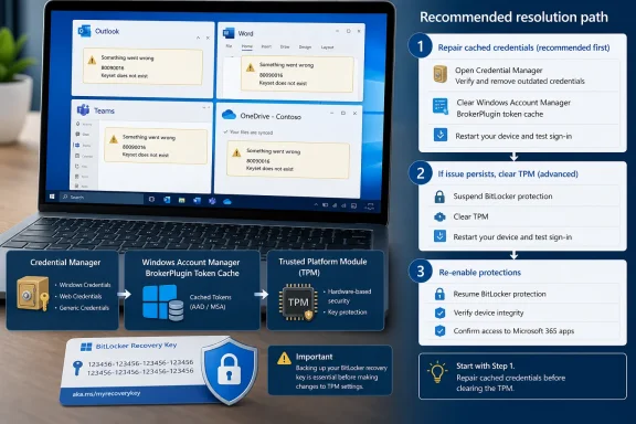

Infographic shows Microsoft 365 sign-in errors and a recommended credential, TPM, and BitLocker troubleshooting path.The first repair is an identity-cache repair​

For an affected user, the low-risk first pass is narrowly scoped:
  • Close every Office app, Outlook, Teams, and OneDrive before changing credentials or token files.
  • Remove only Credential Manager entries clearly associated with MicrosoftOffice16, rather than wiping unrelated saved passwords.
  • Delete the files in the BrokerPlugin and CloudExperienceHost AC\TokenBroker\Accounts folders Microsoft identifies, then restart before signing in again.
  • Confirm that antivirus, a proxy, firewall policy, or VPN is not blocking the Microsoft.AAD.BrokerPlugin_cw5n1h2txyewy process.
That last check is absent from Appuals’ practical first method but appears in Microsoft’s official sequence. It matters in managed environments: a security product that blocks the broker can recreate the symptom after an apparently successful cache reset. Repeatedly clearing the cache without finding that block only guarantees repeated user disruption.
