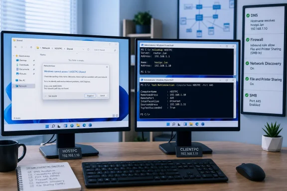

Dual monitors show an SMB network access error alongside successful DNS and port connectivity tests.Start with a direct UNC-path test​
Do not use the Network pane in File Explorer as the main diagnostic. Network browsing relies on discovery and can be incomplete even while a correctly named SMB path works. Open File Explorer’s address bar, or use the Run dialog, and try:
\\FILEPC\ShareName
Then try the same share by its IPv4 address:
\\192.168.1.50\ShareName
Use the share name, not merely the computer address. For example, \\192.168.1.50 may show available shares, but \\192.168.1.50\Projects tests the exact resource your mapped drive needs.
The results narrow the work immediately:
  • If the IP address works and the computer name fails, investigate DNS, DNS suffixes, stale name records, or another name-resolution method.
  • If both forms fail, test the network route and SMB port before changing permissions or credentials.
  • If either path opens but returns an access-denied or credential prompt, the path has been found. That is a permissions or authentication issue, not error 0x80070035.
  • If only the old mapped drive fails while the UNC path works, remove the stale mapping and create it again after fixing the underlying name or credential issue.
