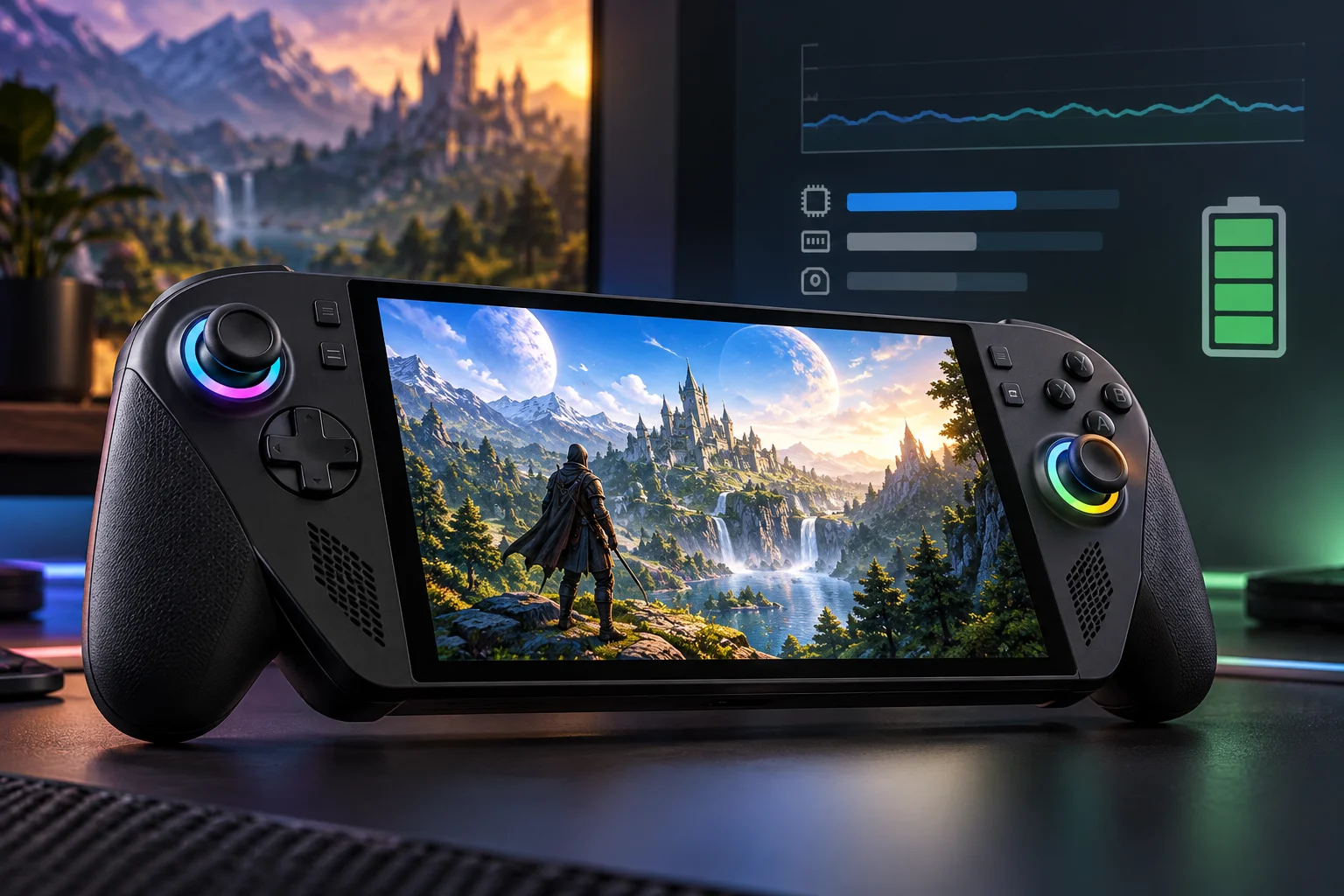

A handheld gaming console displays a fantasy landscape, with performance and battery indicators on a monitor behind it.

A handheld gaming console displays a fantasy landscape, with performance and battery indicators on a monitor behind it. What the X20 actually is​
