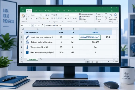

Excel spreadsheet on a monitor showing unit conversions for length, distance, temperature, and data.

Start with a blank area of the worksheet so that the conversion columns do not replace the source data. Use four headings: Measurement, From, To, and Result.
A basic cell-reference version makes the relationship easy to inspect:
  1. Enter the four headings in cells A1 through D1.
  2. Enter 36 in A2, in in B2, and cm in C2. Enter the unit codes as plain cell text, without surrounding quotation marks.
  3. In D2, enter =CONVERT(A2,B2,C2). The expected result is 91.44.
  4. Add another measurement and its unit codes on the next row, then copy the result formula down for that row.
For example, a second row containing 5, mi, and km should produce 8.04672. The formula’s structure stays the same because the number and the units now come from cells. Microsoft documents using a cell reference for the numeric input, and How-To Geek’s workflow extends that arrangement to the unit fields.
