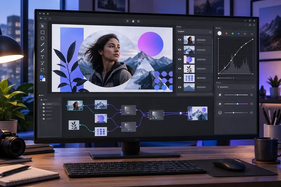

The useful part of Graphite’s approach is that its conventional editing tools sit above a shared node graph. A node represents an operation or an element of the artwork, and connections describe how those elements are processed together. Graphite’s repository explains that its tools wrap this graph, offering a visual editing workflow without requiring users to construct every operation through nodes.
That gives the application two complementary interfaces. Layers help organize the composition, while the graph exposes the operations producing it. The practical attraction is being able to change the recipe behind an effect rather than repeatedly rebuilding its result.

- Place a photograph on the canvas alongside vector artwork.
- Use a vector shape with a Clipping Mask node to control which part of the photograph remains visible.
- Apply a Curves node to adjust the photograph.
- Add procedurally repeated vector patterns over the composition.
According to XDA, replacing the photograph can preserve the mask, adjustments, and vector overlay. The specific workflow and tool behavior are supported by XDA’s account alone, not by an independently corroborated test; the official repository confirms the broader nondestructive architecture.
