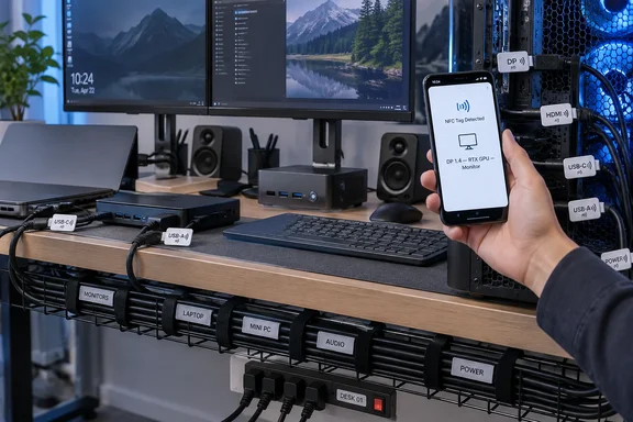

The premise is simple. Put a small NFC tag on the accessible portion of each cable, write a plain-text identifier to it with a phone, and scan the tag when the cable has to move. The How-To Geek setup uses labels such as “DP 1.4 - RX 9070 XT - LG Monitor,” recording both cable type and endpoints rather than an ambiguous one-word label like “HDMI.”
That extra detail is the part worth copying. A desk with two monitors can easily have three or four visually identical video cables; “Monitor 1” becomes meaningless the moment a dock, KVM, laptop, or mini PC is added. A label that identifies both ends turns a physical cable into a small, searchable asset record.

USB-C PD — Anker 737 — ThinkPad T14
DP 1.4 — RTX 5070 — Dell U2723QE
USB-A — Rear I/O — Audio Interface

  • HDMI 2.1 — RTX 5070 — LG C4
  • DP 1.4 — Mini PC — Dell U2723QE
  • USB-C 100W — Charger — Framework 16
  • USB-B — Focusrite Scarlett — Rear USB-A
  • AC — UPS Outlet 4 — Desktop PSU
Where ports are relevant, record them. “Rear USB-A” may be enough for a keyboard; “USB-C TB4 left” can prevent a much more frustrating mistake on a laptop dock. For video connections, record the actual source device rather than merely “PC,” particularly when a desktop has both a discrete GPU and motherboard display outputs.
