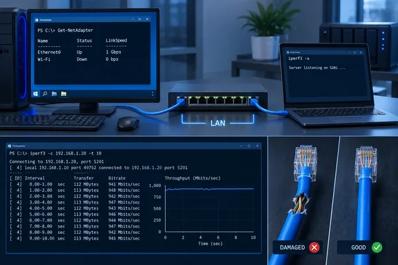

On Windows, open PowerShell and run:
Get-NetAdapter -Physical | Format-Table Name, Status, LinkSpeed, InterfaceDescription
Microsoft documents Get-NetAdapter as the built-in cmdlet for retrieving physical adapter properties. Find the adapter actually in use—normally named Ethernet—and look at Status and LinkSpeed.
For a PC, dock, and switch port that all support Gigabit Ethernet, the expected result is typically 1 Gbps. If it reports 100 Mbps, do not assume the cable alone is at fault, but do treat the result as a meaningful clue:
- The patch cable could have a damaged conductor, poor termination, crushed section, or bent plug.

On the first device, launch iPerf3 in server mode:
iperf3 -s
Find that system’s LAN IPv4 address with:
ipconfig
On the second system, run a 30-second TCP test, replacing the address with the server’s address:
iperf3 -c 192.168.1.50 -t 30
Then repeat in the other direction:
iperf3 -c 192.168.1.50 -t 30 -R
The -R option reverses the sending direction. This is worth doing because a problem can affect one direction differently from the other, and the two PCs may have different CPUs, adapters, drivers, or docks.
If Windows Firewall blocks the test, permit iPerf3 only on the trusted private network needed for the diagnostic. Do not expose an iPerf server to the public internet or broadly open an inbound rule on an unmanaged network. Microsoft’s iPerf walkthrough likewise calls for a firewall exception between the test endpoints.
Interpreting the result without overdiagnosing
A direct Gigabit Ethernet path commonly produces throughput in the high hundreds of megabits per second after normal TCP and Ethernet overhead. It will not normally display a literal 1,000 Mbps payload rate. If the adapter has negotiated at 1 Gbps but iPerf3 stays near 90–95 Mbps, something in the test path is still operating at Fast Ethernet speed.

The best confirmation remains a controlled substitution: replace the suspect patch cable with a short cable known to work, without changing the PC, port, or switch. Re-run Get-NetAdapter and the same iPerf3 commands. A jump from 100 Mbps to 1 Gbps link speed, followed by a major rise in local throughput, is strong evidence that the removed cable was the problem.
Cable testers help, but have limits
A low-cost continuity tester can quickly identify an open conductor, short, crossed pair, or incorrect pin order. That makes it useful when a cable is visibly damaged or a hand-terminated cable is suspected.
It does not certify that a cable meets Gigabit Ethernet requirements. HPE’s guidance highlights signal characteristics including attenuation, near-end and far-end crosstalk, equal-level far-end crosstalk, and return loss. Cheap testers generally do not measure those. A cable can pass a simple pin-to-pin test yet remain unreliable or fail to negotiate at the desired speed.
