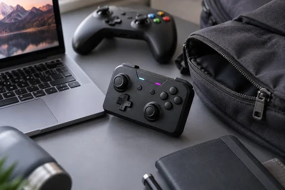

Digital Foundry describes a boxy 133 x 75 x 24 mm body with two staggered low-profile sticks, triggers placed inline with the shoulder buttons, and mode controls along the front edge. The main hardware points:
- Sticks: TMR (tunnel magnetoresistance) sensors in recessed housings. Basic Tutorials notes this type of stick is said to be more drift-resistant and durable than potentiometer sticks.
- Triggers: optical linear triggers with a switch for about 4 mm of travel (full analog) or about 2 mm (quick actuation). JSAUX cites 1,280-step sampling.
- Buttons: membrane face buttons rather than clicky microswitches, which Digital Foundry points out. JSAUX's spec sheet lists the ABXY buttons as pressure-sensitive.
- Extras: six-axis motion, dual HD rumble, RGB indicators, and ML/MR back buttons for mapping and macros.
- Power: a 1,000 mAh battery. JSAUX estimates about 10 hours of play and about 3 hours to charge over USB-C. Those are the manufacturer's figures, not review measurements.
The reported weight doesn't agree across sources. JSAUX's spec sheet says 113 g. ROG Ally Life's launch coverage described a 104g portable controller, and Pocket Tactics quotes both 104 g and 105 g in the same review. Either way it's featherweight.
Section summary: a $49.99 pocket controller with TMR sticks, switchable optical triggers, gyro and back buttons. The weight is somewhere between 104 g and 113 g, depending on who you ask.
